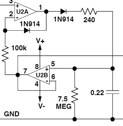

The circuit in 56 does not do the job of a peak detector. The output of the op amp has probably 5 - 10 mA available to charge the 33 uF cap, which means the fastest rise time it can "track" is about 0.3 V/millisecond which is very slow (probably 100X too slow for audio). Anything faster and it just waves as it goes by. To be a peak detector, that cap needs to be a lot smaller (I would recommend maybe 0.22uF CER) The circuit as shown in 56 is so slow it is more of an averaging meter than peak reading. It will read peak value only if the signal is there long enough to let the cap charge up fully which for a 20V signal would be about 70 ms.
The circuit shown below is a peak detector which will work. If +/-15V supplies are used, it could handle a 24V (p-p) input signal. Best to use J-FET input op amps to minimize leak off. Something like TL-084 or TL-074 would be a good choice, but for cost savings LM358 could be used (just need to minimize input bias current).
The signal in (from the left) looks into the non inv input which would be very high impedance so you would not need the "buffer" stage shown in 56 curcuit (saves one op amp), all you would need is a large resistor to ground for DC bias. You could use 200k Ohm so the circuit would not load your signal source.

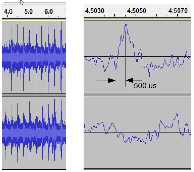

The importance of a peak detector being able to slew fast enough to track the peak is easily seen in a sample of an audio track. The sample shown below is shown zoomed in on the right side so that each major time division is 1 milli second. As the example shows, the audio signal slews about 70% of total amplitude in about 500 micro seconds. If the signal was scaled so this was a 20V (p-p) range, the signal would be a 15V excursion. That means the peak detector would have to be able to slew about 30V/ms to follow this particular signal and this one was picked at random.

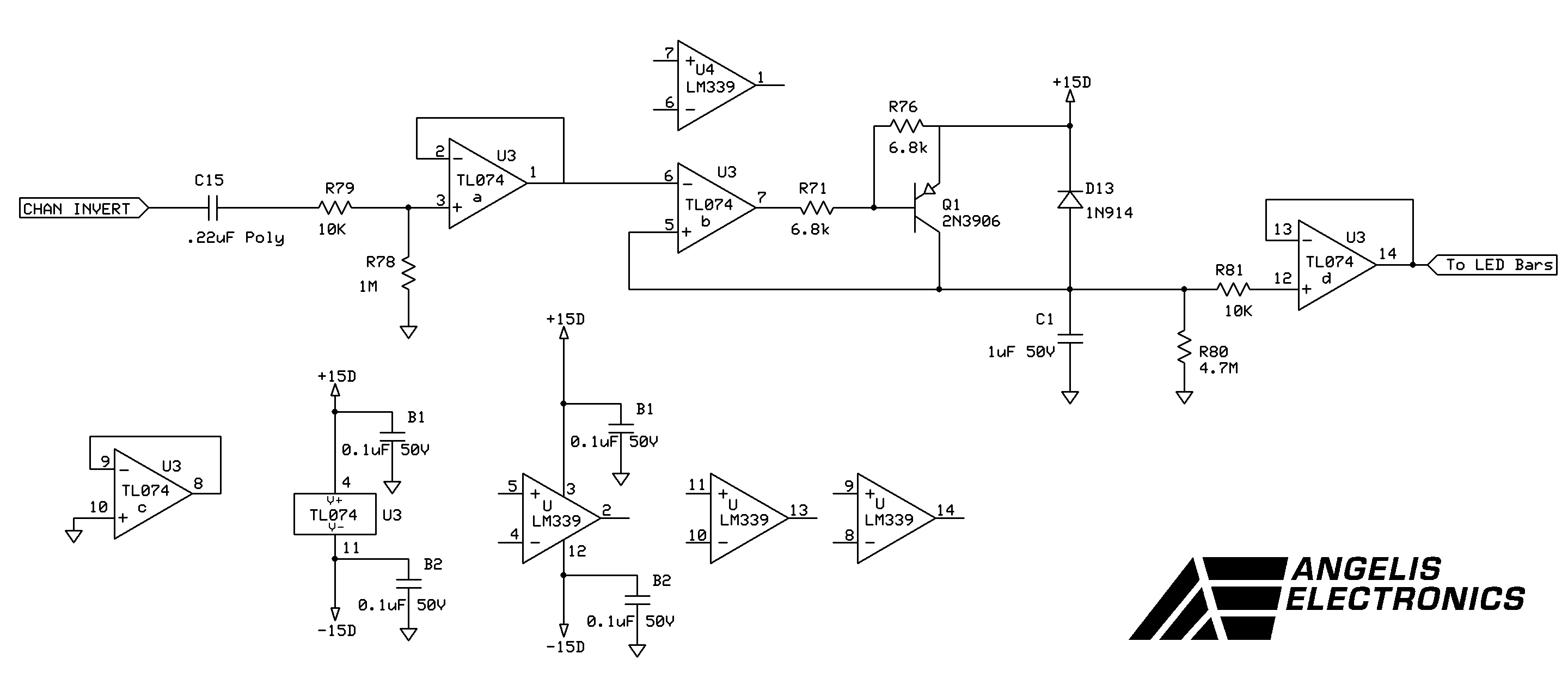

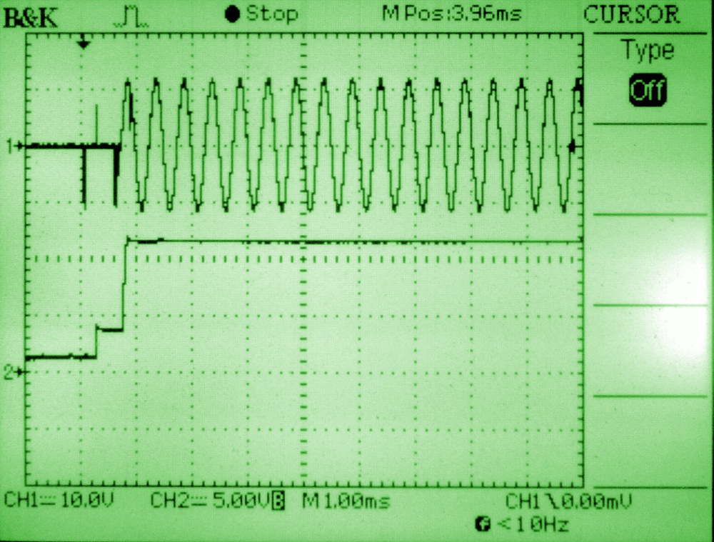

I couldn't get the idea out of my head about using a comparator circuit, so I gave it another go. This time I stopped fooling around with slow op amps and wanted to grab a TL074. Didn't have any so I used a TL084. Pretty much the same thing, both fast and slew-y. I also wanted to try an LM339 but out of them also, found a similar two-comparator chip the LM393 I was going to try. Also quite similar to the '339.
Being as lazy as I am, I started out the breadboard circuit just using the TL084 as a comparator, but set up a PNP output that literally DUMPS more than 100mA into the cap (Tim "the tool man" Taylor would be proud). It was still 1uF because I just wasn't getting the hold time with 0.1uF. The other nice thing about the TL084 is the JFET inputs sip so little current, great for the holding cap which is potentially drained by 2 op-amp inputs, and the input buffer. Not sure how well the '84 would work as a comparator, I did have the LM393 on standby duty.
The performance of this circuit worked so well I had no reason to introduce another LM393 package and it's typical pull-up resistor. It responded within a few percent or so from 20 Hz to 20,000 Hz at the full 24 volt pk-pk signal input. This pix shows a single transient input at 22.8 volts pk-pk, and the resulting output immediately jumps up to about 12 volts within about 100μSec. You can even see how it caught that little hump before the scope even triggered.

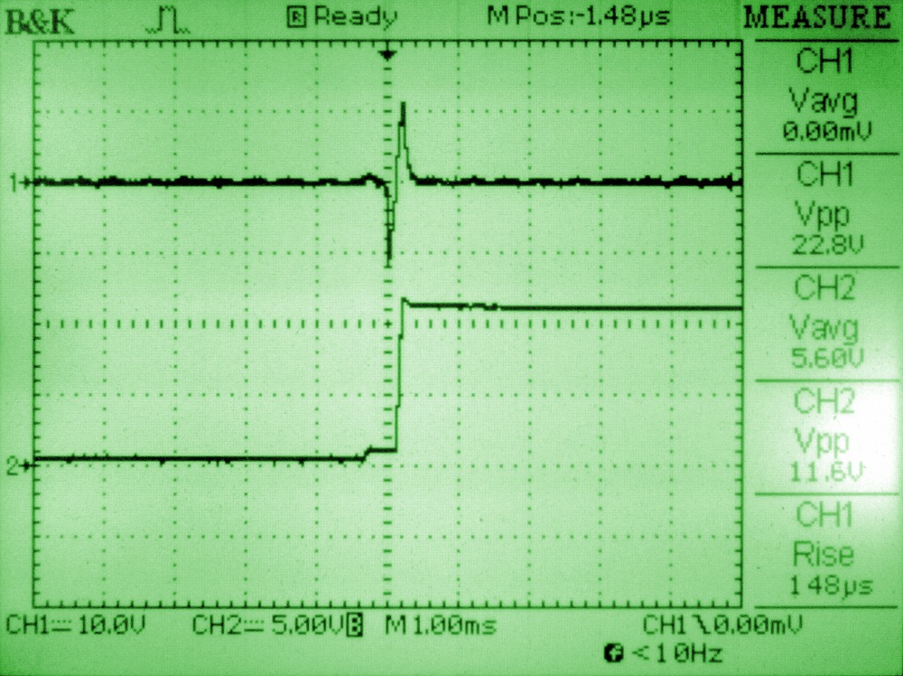

This next pix shows the response when a 2KHz signal was switched up +20dB. It even caught most of that single little spike before the sine waves get big. I don't have pix of it, but this same response showed itself through the full 20 - 20K range.

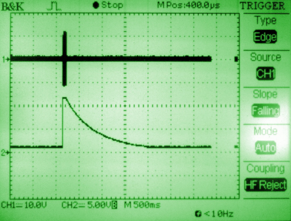

Here I test the overall peak hold with a small burst of 2K. It settles out completely within 2 seconds. That was using a 1 Meg Ω bleed on the 1μF cap. I wanted more.

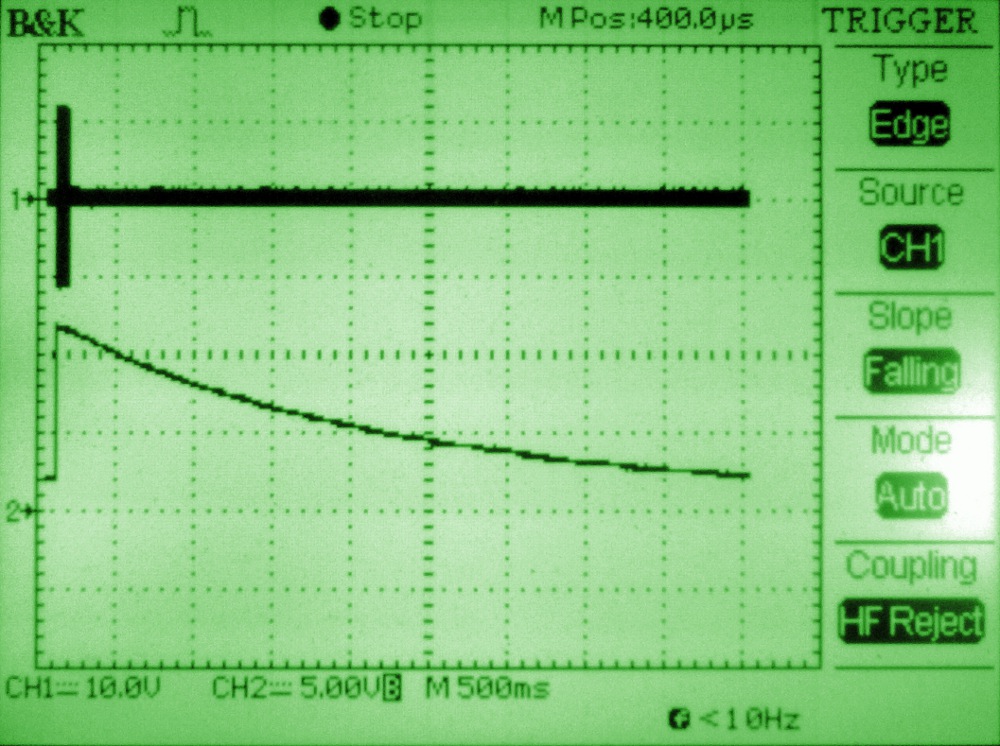

With a 4.7 Meg Ω bleeder resistor, I get about 5 seconds before the meter settles out. In my application, the next -3dB LED will switch about 8/10 second later at about 8.5 volts.

Hy Rich,
Circuit is looking good.
May I make a few suggestions:
(1) Change PBJT from 2N3906 to BC327 or similar higher current transistor. The BC3906 hFE is struggling a bit after 20mA and hfe will be much worse.
(2) Change R76 from 6K8 to 1K to speed the transistor turn off by emptying the base charge faster.
(3) Change R71 from 6K8 to 3K3 to hit the base of the transistor with more current and to pull the opamp output up faster to aid turning the transistor off faster.
(4) Change R79 from 10K to 1K (22R would be OK) to feed the TL072 with a lower Z to give better noise and transient response.
(5) Change R81 from 10K to 1K (22R would be OK) to feed the TL072 with a lower Z to give better noise and transient response.
(6) I would be inclined to replace the 4M7 resistor to 0V with a constant current sink so that hold -dV/dt (drop on the hold capacitor) is constant throughout the voltage capture range. 20M Ohm or higher down to -15V would approximate a constant current, if you didn't want to go for anything fancier and generate a true constant current that is.
(7) Also, if you haven't done it already, I would suggest putting some heavy duty, high frequency decoupling directly between the emitter of the transistor and the 0V of the holding capacitor: 100nF ceramic capacitor in parallel with a 47uF solid tantalum capacitor would be the sort of thing. I notice from your schematics that you are strict about decoupling opamps.

Spec:
1) OK, I have some PN4355's that will give me Hfe of 75 up to 500mA. I was going to use them if I was having trouble.
2) I'll go to 3.3K on the base resistance, but that's my final offer. That thing will have almost 30 volts across it.
3) Oops, that was the other one. See, we think the same. I'll make this 1.6K because I have some 5%.
4) Sure, whatevs.
5) Shure, whatevs. BUT, at that point all we are doing is turning on LEDs, so noise & transient response don't really matter.
6) Wow, I had that idea also, using a simple JFET as a crude current regulator. I just didn't feel like playing with it because it was late.
I'll try it once, but if it doesn't work, screw it, I'll use a resistor. I can see how a 20MΩ could simulate that and that will be my back up plan if I can't find 40V FETs.
7) I'm not usually strict about schematics I use for design ideas. When I "go into build" I get anal about documenting.
Also, I DO put decoupling wherever I am using higher current transistors - so I'm sure I'll put a few in there on the final board because it will share the PCB with audio circuitry. I will probably put a ground 'wall' to separate the analog from digital area and feed the signal through. I don't want those LEDs causing clicks. Already I'm planning to use a separate +/- 15 volt supply for isolation.

Hy Rich,
good stuff- I think we all speak the same language on this thread. Just a couple of points though:
(3) The TL072, although a sweet sounding baby, is not big on output voltage and current drive, like some of the the later rail to rail output types (OPA192). For that reason the 3K3 resistor will only have -10V to 14V = 24V across it at DC. Dynamically it will be quite a bit less because the TL072 is no greyhound. Still you have made me happy by putting a 3K3 resistor in. I hope it works OK
(4) I really would go to IK across the base: that only gives 600uA base clearing current and only 600mV aiming potential which isn't much, especially with the collector whipping around so fast and boosting Cbc into a relatively large virtual capacitor at the base, not to mention Cbe in parallel. You should have around 6mA flowing through the 3K3 resistor so there will be heaps of base current drive and the transistor will turn on fast, but turning off is not so good. I was going to suggest chucking away 1mA and putting a 560R resistor across the base, still leaving 5mA base current. It is normally harder to turn a transistor off than to turn it on, in my experience anyway.
I will get my coat now. :happy:
spec
Spec: OK, I was holding off at 1.6K because I have some 5% around, that decision was purely economical - I'll save a full penny or two! My records don't show it but I'm sure I have 1K 5% somewhere so I'll put that in -or- I know I have 560 5% resistors if you really think that's best.
bountyH: I tested it with a pulse going from -10 to +10 in 150μSec. The output seemed to have about 1/2 to 1 v overshoot. (That's the 1st scope pix up at #89.)
I think if I make the changes spec suggests, I can improve that overshoot by turning the transistor off a bit quicker, but I don't consider it a big problem for this particular use. If a user sees the LED signal at a slightly lower input level than ideal, he/she may turn down the gain a bit, but the overshoot should only make a difference of a fraction of a dB.
