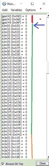

Hi N,
The serial is being used for other things, and only one use is allowed.
Do you mean like this?
C
MASTER
For spipsn = 0 To 34 'spipsn To 34 '49 'GPS=31 $-W INC QEI=2 BATVOLT=1 SPARE DATA=1<<£
SSPBUF = m2s(spipsn)
While Not SSPSTAT.BF
Wend
s2m(spipsn) = SSPBUF '£ ADDED
'Hserout "S2M(SPIPSN) ", #spipsn, " ", s2m(spipsn), CrLf '£
'WaitMs 5 '<<<<<<<<<<<<<<
Next spipsn
SLAVE
For spipsn = 0 To 34 'GPS=30 $-W INC, QEI=2 BATVOLT=1 SPARE DATA=1'<<<<<<<<<<<<<<<<<£
SSPBUF = s2m(spipsn)
Wend
m2s(spipsn) = SSPBUF 'M2S
Next spipsn
