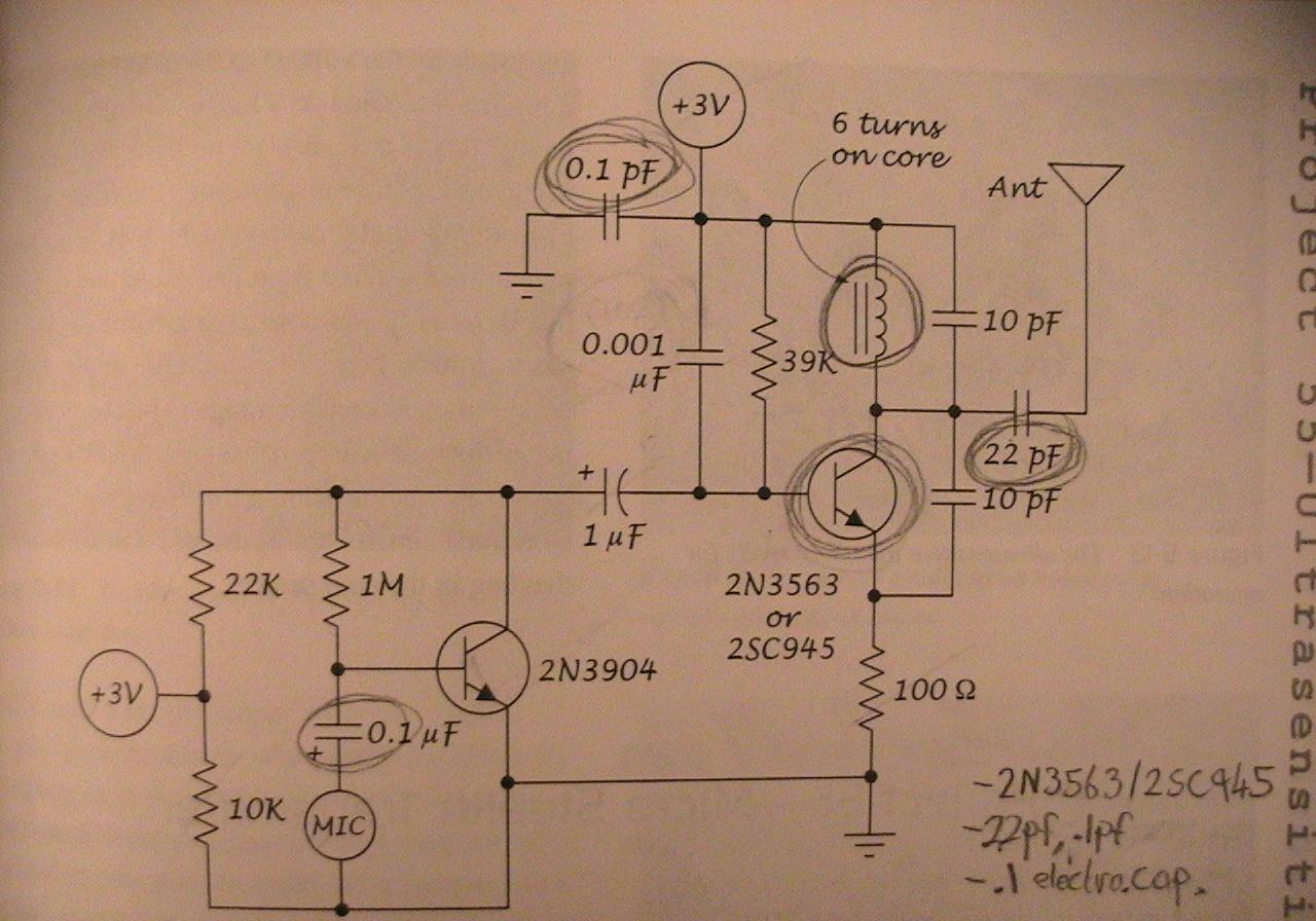

As for the 0.1 pf cap I will post the schematic so you can see. It is an ultra sensitive FM transmitter.
I thought that sounded a bit too small... but its on the schematic..

The circled part is just a bypass on the power input to the stage. It should be 1nF to 10nF.
Which one Mike, there are 5 circled parts.
The 0.1pf cap in the diagram is obviously an error. Use something between 0.001uF and 0.1uF or so. For the 0.1uF cap on the mic use a poly or mylar for lower distortion. A ceramic would add some distortion, but I doubt you'd notice it in this circuit anyway. There is no need for it to be an electrolytic capacitor. If you did use a electrolytic capacitor, they marked the polarity wrong on the diagram to boot. ;)
What sort of MIC is that? If electret, the circuit will not work.
The supply decoupling should be 10n to 22n
What freq are you transmitting? The 10p should be 39p to 47p at 88MHz to 100MHz for best "Q"

It should be 3t - 4t on 2.6mm dia F29 ferrite for 88MHz to 100MHz.
I think you are correct about the mistake because I took a look at the previous project(see attachment) which was derived from the one I am working on and it looks like it was supposed to be 0.1 µf.Do you think I could make that assumption? The 0.001 µf was circled by accident...:o

It is electret and why won't it work?
What is supply decoupling? What is "n". What is "p". (Picofarad maybe??). And what is F29 material? I am using a coil of copper wire around a ferrite core.

It looks like you got the mic bias resistor (10K) wrong in your "derived" diagram. That's probably why collin55 is asking about the mic type.
Use ceramic for all the capacitors. I have sold over 100,000 kits and the audio is so good that you cannot tell if someone is talking in the next room or the sound is coming from an FM radio.
<mod edit: self promotion deleted. If you have content to share, please post directly to ETO. Do not link to your own personal website>
The purpose of the 22n to 100n across the power rails is to reduce the impedance of the rails when the battery gets weak.
You must connect the battery ( 3v) as close as possible to the circuit otherwise the power rails will become "radiators" and the circuit will not work at all. This is much more evident if the 22n is not included. This is called "supply decoupling" or more accurately "supply coupling" or "supply impedance redcuing." But it is generally given the term "supply decoupling" as we are effectively decoupling the 3v rail of the project from the battery and making the circuit "tight." A "tight" circuit allows the transistor to "push and pull" the signal "into and out of" the antenna and thus produce electromagnetic radiation.

Two faults in the second circuit have been noticed:
The coil has 10 turns, making the capacitor about 20 - 25p for 90MHz. The ideal Q for this frequency is 5 – 6 turns and 39p.
Secondly, the air trimmer should have a 22p ceramic across it so the trimmer only adjusts a small amount of the capacitance. It makes for a more-stable operation and easier to fine-tune
