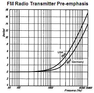

Colin's FM transmitters are missing pre-emphasis so their audio frequency response drops -3dB at 3.2kHz, -6db at 6.4kHz and -18dB at 12.8kHz. 15kHz is way down. This is for the European, Australian and New Zealand's 50ms curve.
In Canada and the US (75us curve) it is much worse: -3dB at 2.1kHz, -6db at 4.3khz and -18dB at 12.8kHz. 15kHz is almost zero.
Also, his input coupling capacitor has a value that is so low that there are no bass frequencies.
My FM transmitter has a frequency response that is -3dB at 21Hz and is flat up to 20kHz where it is -1dB.
Here is a graph showing how much pre-emphasis is needed in an FM transmitter. +17dB at 15kHz for North America!
My FM transmitter has it, Colin's doesn't.

Rather than going on the defensive, why don't you read about pre-emphasis and decide your yourself?

Why not investigate the possibility of designing a premium version of the kit which includes pre-emphasis for better sound quality?

Pre-emphasis in my FM transmitter costs just one resistor and one small capacitor.
