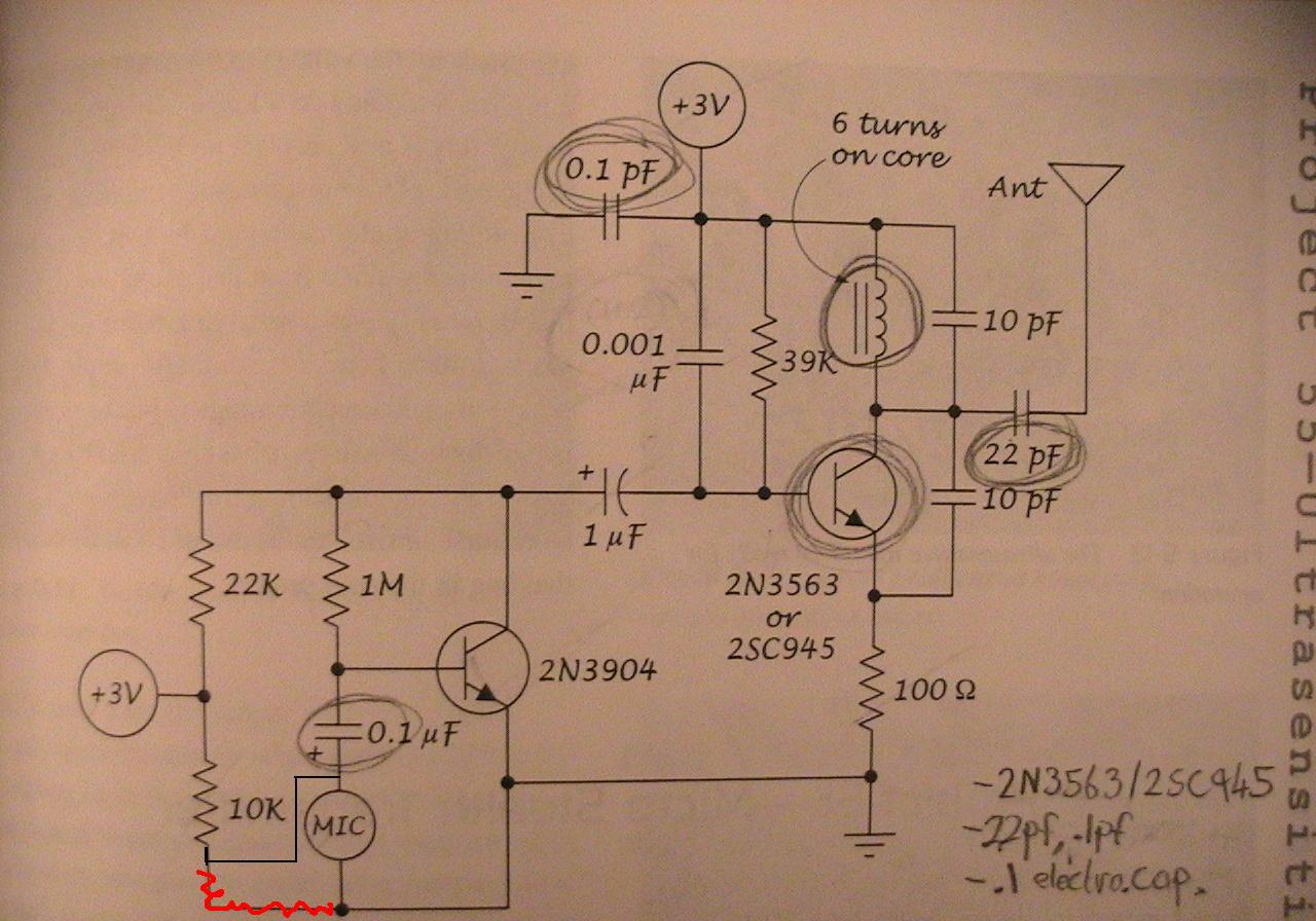

And I found why the MIC is not getting power. PIC ATTACHED.
And is there a positive and negative side on a mic? Howw do I tell which is which?
Edit its attached nw
So should I just go right into it and solder everything together?
no image attached.???
EDIT:
Looking at the circuits I would build the one posted by 'audioguru' at least you will know when you have built it will work.
Sorry.. its attached now. So should I go right into soldering it?

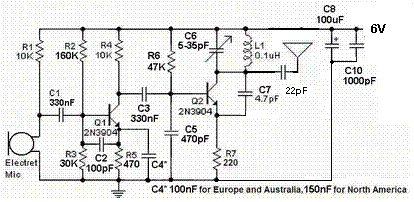

You could chop off the regulator and the additional RF power stage, but it wouldn't be as stable (frequency drift) and wouldn't have the same range (Output power):

Your FM transmitters do not have pre-emphasis (treble frequencies boost) like FM radio stations use. So your FM transmitters will sound muffled on an ordinary FM radio because all FM radios have de-emphasis (treble frequencies cut) and therefore your transmitters will sound bad with no treble frequencies like an AM radio or like a stereo with its treble tone control turned all the way down.
My FM transmitter sounds perfect because it has pre-emphasis.
I have already suggested visiting my site and building one of the following FM Bugs:
See Wasp or Voyager on <snip> website for a much-better design
<mod edit: self promotion deleted. If you have content to share, please post directly to ETO. Do not link to your own personal website>
