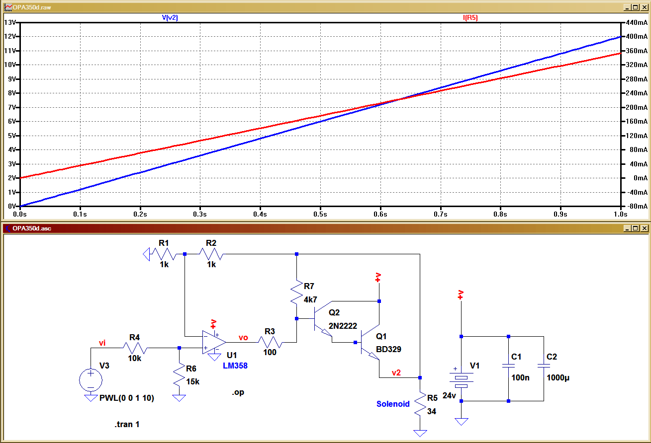

1.2 Gain 350mA amplifier
Much appreciated Eric! What software did you design this in?
Its LTspice, free download the asc file for LTS attached.
Note with the higher voltage the output transistor will need a heat sink, if it runs to warm, use a higher powered transistor.

So i tried the circuit. My OPA gets hot and circuit doesn't work. Just for fun, I tried wiring the transistor straight to my input signal (Limit 0-10V instead of desired 0-12V) and it works wonderfully, except I cant get to the top end of my control (since I am missing a full 2volts of signal).

This would give a simple fix.
EDIT:
Checking the original circuit, I can see no reason why your LM358 is running hot.
The opamp will get hot if the pins on the transistor are connected wrongly (or the collector is not powered) so it has no current gain.
