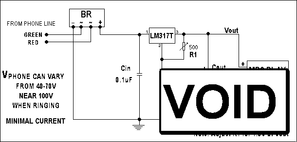

eblc1388 said:
While Mr. ionic is conjuring up the circuit from his wonderful idea...
While Mr. ebcl1388 may have the more practical and safer approach my theoretical but possible circuit solution is posted below.
P.S. It may need some tweaking though...
The phone line will be off-hook all the time when this circuit tries to steal current from it.
The current from a phone line is much too low to power an MP3 player.
The pot connected to the LM317 does not adjust its voltage. Pin 2 is grounded so the output voltage is fixed at 1.25V but will rise to about 1.5V without a load.

iONic,
Your circuit has a lot of problems. :(
1. The absolute maximum input-output differential voltage for the LM317 is 40Vdc. The ON-hook line voltage is nominally 48Vdc. Ring voltage is around 96Vac
2. Phone lines are not intended to be power supplies for other devices, so attaching you bridge directly across the line and supplying the needed current for the MP3 player will load down the line. As the current increases the line voltage drops...probably to the point of creating an Off-hook condition. Phone companies don't like this. If I recall correctly, the maximum current available in an Off-hook condition is about 20mA.
3. Your variable resistor from pin 3 to pin 2 will only work if there is a fixed resistor from pin 2 to ground. And with that, Cout's negative terminal would be connected to LM317's pin 2 as opposed to ground.
You don't think that you can get 100 - 200ma from tthe phone line?
Your right about the 500 ohm pot, it should be replaced with a 240 ohm fixed resistor and place the pot from pin 2 to ground.

iONic,
Your imagination is great...and your pile of junk seems adequate. ;) Just felt that clarification was in order in case someone might try actually hooking this up. I have seen (and built) connections to the phone line to power LEDs to detect On-hook /Off-hook conditions...but these only draw <1mA. Had to do a lot of reading (pre-internet) about phones to find out where "my" designs were going south. Keep up the "what if" attitude. :)
Ken
Generally the phone lines feed a current limited (each limb) supply of -48V and earth.the limit is around 35mA, but as the line loop resistance increases (for the far off phones) the current would less.
added to that, the lines don't care about 3 to 4 mA of leakage current in the modern exchanges. It amounts to misuse of telephone line to tap and connect devices across the phone lines, and certain telecom companies can even object to it.
