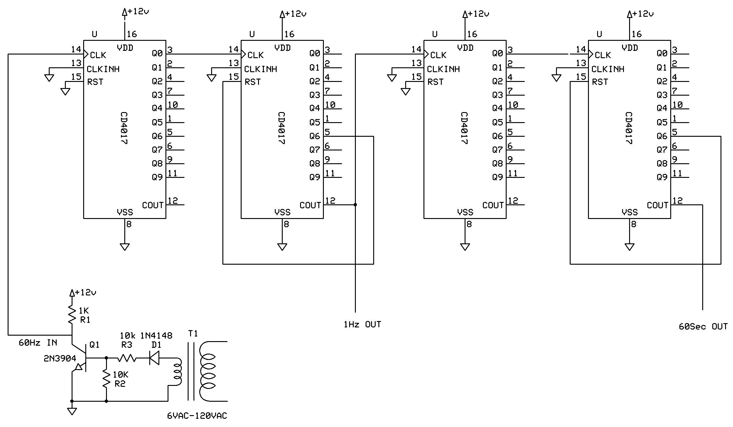

I used the following circuit to generate a 1Hz clock form the 60HZ power line. I added a second ÷60 section (2 more 4017s) to get a 60sec output. Hope this helps.
Ken
