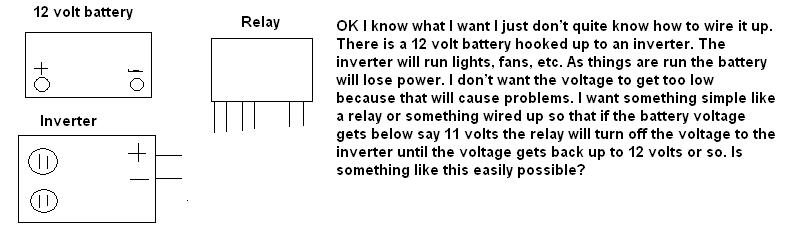

Can someone help me with this?
The inverter is shutting power to the light but stays on itself and just keeps beeping. That's why I want to shut down power to it completely.

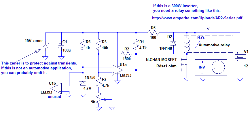

No, I left it beeping for over an hour today just to check. It's a Portawattz 300 inverter. I have no diagram. Is it that hard to do a circuit for it? I was hoping to just connect the coil of the relay to the battery and somehow sense when the voltage got below a certain point shut power off to the inverter until the voltage got above 12 or 12.5 volts and then come back on by itself.
Here you go. You should be able to connect the relay contacts in series with either the + or the - terminal on the inverter.

crunch53 said:
Do I understand you right? I need to put the relay in my inverter.
No. The inverter just connects to the N.O. contacts of the relay. It does exactly what you want it to do - switches the inverter off when the battery voltage drops below 11 volts, and back on when it gets up to 12 volts.
OK, so I just need to make that circuit then right. What do I need to change if I want those voltages a little different?
As designed, the hysteresis is about 1 volt. The pot determines the switch points. In other words, if you set it to switch off at 11 volts, it will switch back on at 12 volts. If you set it to switch off at 10 volts, it will switch back on at 11 volts. You can change the amount of hysteresis by changing the value of R2. To double the hysteresis to 2 volts, change R2 to around 75k. The pot should still allow you enough threshold adjustment range. The pot will affect the hysteresis to some extent.
We could make a circuit with independent (non-interactive) on and off points, but it would require more parts.

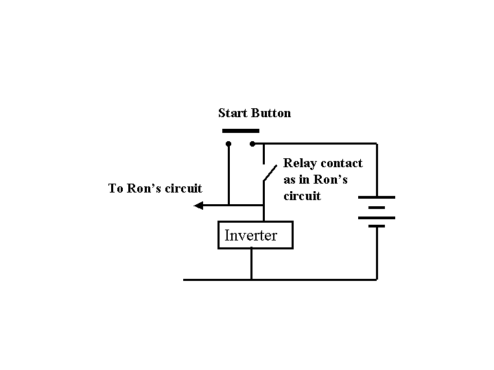

If I understand what you want, it is to switch off the current that is being drawn from the battery when the voltage falls to 11 Volt. Ron's circuit will do this, but there will still be some current drawn by his circuit.
This could be avoided by connecting the Vcc line of Ron's circuit to the + side of the inverter.
And connect a push button switch across the relay contact.
You press the button to start the inverter and, if the voltage falls below 11 V and the relay releases, you will have to manually restart (ie. push the button) when the battery is recharged.
Edit, I have attached a drawing
