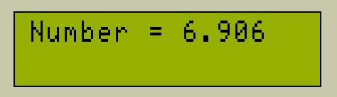

So you want to create a value from 5.000 to 8.000? Assuming your compiler supports Floats (decimal numbers), you could create a rather simple random number generator (This would be the PIC Basic equivalent - I don’t use C sorry)
Device = 18F458
Xtal = 20
Dim Random_Number as Float
Symbol Min_Val = 5
Symbol Max_Val = 8
Cls
Print At 1, 1, "Number = "
SEED $0345                                                        ' Put the pointer in the middle of the random table.
Main:
	 Random_Number = Random                                   ' Generate a pseudo-randomisation on Variable.
	 Random_Number = (Random_Number / 65535)                  ' Perform The math to create a number from 5 to 8.
	 Random_Number = Random_Number * (Max_Val - Min_Val)      ' Proton only allows upto 3 values per equation,
	 Random_Number = Random_Number + Min_Val                  '  thats why they are broken up onto seperate lines.
	 Print At 1, 10, DEC3 Random_Number                       ' Display the value on the LCD
	 DelaymS 250                                              ' Small delay
	 Goto Main                                                ' Loop for eve
Click here to watch the Program in action.
Thats just throwing info on an LCD, to delay for that many seconds, simply scale up the value and use what ever the equivalent of DelaymS is, eg,
Random_Number = Random_Number * 1000
DelaymS Random_Number
The above was all written in Proton PIC Basic
