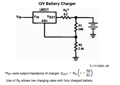

I found a schematic on the LM317 datasheet (attatched). How does Rs limit current? I'd like to use this to charge my motorcycle batteries (7AH and 12AH), not at the same time. Will it work alright? It'd be powered by an 18v 680ma DC output walwart.
Right now I charge the battery with a 12v 100ma DC output walwart, it takes a few days but it does charge it. But I'd like a little voltage protection (the 100ma 12v is 15.51v with no load, so I'm sure eventually it could get the battery there), and also 100ma just takes forever to charge a battery. 680ma would get it charged in less than 24 hours.

Yes, that will do it. Rs makes the charger look like it is driving the charger through a resistor (2.2Ω) that's bigger than the one in the circuit (.2Ω) by the formula at the bottom. With those values it should put out about 13.75V, so you have voltage and a certain amount of current limiting.

The current will be zero when it hits 13.75V, no problem there. This is a very good circuit for what you want. If it was deep discharged, there would be some issue with it taxing the wall transformer.

Why will the current be zero when it hits 13.75v? Is that due to Rs? What if it hits 13.75v before the battery is done charging?
Also, my 100ma transformer charged it fine...it took half a week, but it did it. So could I just leave out Rs then since it doesn't need any current regulation? Also, what wattage resistors should I use?

When the battery's internal voltage hits 13.75V there will be no differential between the charger and the battery, so no current. If you check the unloaded float voltage of that lead acid battery, fully charged and disconnected from anything, I believe you will find it's over 13V. 13.75 is an excellent choice for the charge point voltage.
It's normal to see the charger at full voltage across a battery that hasn't REALLY finished charging. To do that, you need to measure the current.

Rs just makes the LM317 appear to have a 2.2ohm power resistor in series with it. Incredibly, with a maximum output of .68A, all those resistors can be quarter-watt. But use a 1 watt for Rs, a really drained battery might just pull more more current.

Probably. The battery can easily handle more current, Rs is mainly in there to reduce the load on the LM317 when it's dealing with a heavily discharged battery. It DOES have some internal protection against over temperature (high wattage). Help it out and give it a good heatsink, this is a series-pass regulator. The wallwart will almost certainly put out more current than 680ma if the voltage is loaded to under 12V. Try hooking an ammeter (on a high setting) in series with the wallwart and a heavy load (a headlight or something). See how much it can REALLY put out. THat's what the regulator is going to have to deal with
So if I put a large heatsink on the chip, it should be fine without Rs? And I can use standard 1/4w resistors then for the R1 and R2.
Sounds good to me.
Use a heatsink either way. Rs isn't really necessary. R1 and R2 can be 1/4w.

If I was wanting to limit it to 500ma output, what value would I use for Rs? Is that the Zout equation? If so, I get 0.22 with the stock values. Would that mean with 0.2 ohms at Rs it would put out 0.22 amps (220ma)?

Yes, you can put a LM317 configured as a current regulator ahead of a LM317 configured as a voltage regulator. They need a 1.25V drop minimum, and you have 18V to work with.
