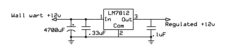

I know that I am bring my dead post up again, but oh well. I am finally getting around to building this thing that I am working on and I am making the PCBs. I want to make sure my circuit is essentially flawless. My question is did I get your regulation description right exo? I don't seem to understand how adding a cap in parallel will cause the voltage to rise up to 16V. It is just charging to the 16V peaks, and then discharging that 16V when the wallwart is at lower potential? Clarification would be great :D

// I can get rid of the .33uf Cap right, since it is just adding .33 to the 4700uf?
No, the 4700 uF has a high impedence at high frequencies, so it needs a 0.33 uF in parallel since the 0.33 uF has a low impedence at high frequencies. The low impedence at high frequencies is important for the stability of the regulator. It will also attenuate high frequency noise (such as radio stations) from the power mains that may otherwise affect whatever circuit you are powering.

Great! I understand it much better now :D (I assume my schematic is alright)
So do I need to load the wall wart down and look at its performance under an oscillscope, or do you think I can just hope for the best :S. I would test it but it will be hard for me to get a hold of an oscillscope.

Your "schematic" looks alright.
Although a scope would be ideal, you can do it without one.
Measure the DC voltage with a dummy load (to draw the maximum current) and then switch the voltmeter to AC and you will measure the ripple voltage. You may (depending upon the type of meter) need a capacitor (1 uF or greater) in series to block the DC.
If you double this figure, it will give you an approximate measurement of the peak to peak ripple voltage. It won't be exact since the meter (unless you have a true RMS meter) is designed to measure sinewave voltages.
I looked at the spec for the 7812 and it has a typical drop out voltage of 2 Volt. So I suggest you ensure that there is at least a 3 V differential.
