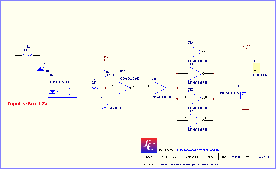

Project brief:
To create an off-delay circuit for an external cooling solution for an Xbox 360 games console.
Basically, I have an Xbox 360 console which used to have a problem with the 3RLOD, I decided to remove the stock heatsinks and install a Koolance external water cooling system. This has remedied the fault with the console superbly (the console now operates at a max. load temp. of 43 deg. C.) and the 3RLOD hasn't returned in over 6 months of use since the mod was completed.
The issue which I have however, is that the external cooling solution must first be powered on from it's own seperate 12vdc power supply before the console can be powered on, aswell as having to remember to also switch off the cooling solution once I have had enough of getting my butt kicked at Halo3 by some grotty little 5yr old. I am concerned that either I might forget to do this one day or somebody else will come along and have a play but forget to turn on the cooler, which will most certainly lead to my Xbox 360 burning out.
I would like to create a circuit whereby upon powering on the Xbox 360, an off-delay timer circuit of some sort, fed from the Xbox 360's internal 12v supply, switches & holds on the seperate 12v supply to the cooler using a latching relay, then upon powering down the Xbox 360, the circuit will hold in the seperate 12v supply to the cooler for an additional 10 mins or so to allow it time to dissipate any residual heat from the system. I have read in places about using a 555 timer but i'm unsure exactly how to accomplish this.
Although the Xbox also operates using 12vdc which can be used to power the circuit, the seperate 12v supply must feed the cooler. I wouldn't like to run the risk of overloading the Xbox 360's PSU.
I would be very appreciative of any help that you guys could offer.
Thanks, WinMXer.

The following circuit will do what you want. The X-box 12V supply will discharge the capacitor and turns ON the MOSFET to power the cooler.

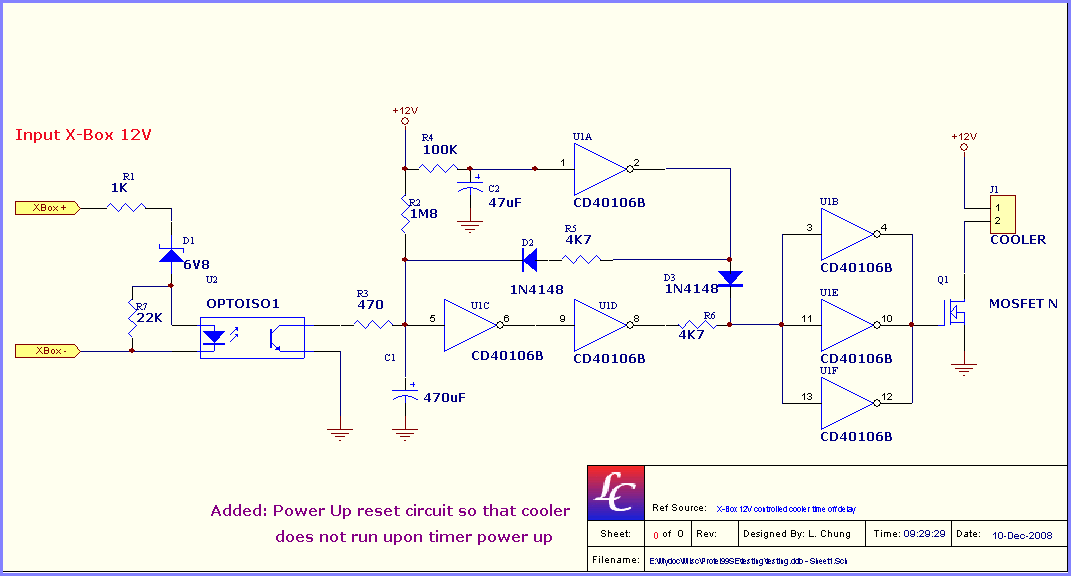

When the X-Box is off, the capacitor slowly charge and after about 10 minutes, the cooler turns OFF. This simple circuit has the problem of running the cooler upon power up for ten minutes even with the XBox OFF initially. If that is not acceptable, then the second circuit will address this problem. A power ON reset circuit is added so that the cooler will remains OFF during timer power up.

Hi L.Chung.
Thank you very much for taking so much time to create the schematic that you posted. I feel bad for saying that I think it is a bit too complex & expensive for my needs.
I'm basically looking to create a simple 555 timer relay circuit that will be powered by the Xbox's 12v supply. Upon applying 12v from the Xbox to the circuit, the relay will energise, pulling in the N.O. contacts. Upon loss of power, ie. turning off the Xbox, I want the 555 timer circuit to hold in the relay for an adjustable period of time, between 5 to 15 mins'ish.
Should the Xbox be turned on again within this Off-Delay period, the circuit is to reset to it's standard state.
I know that this is possible, but have no idea how to draw up the schematic.

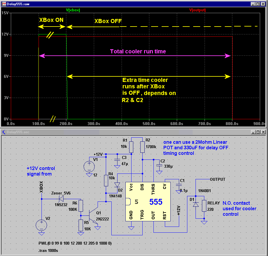

Let's restate your problem:
"I want to control a 12V cooler on a separate +12V power supply using 555 and a relay. The cooler is to run immediately when there is +12V DC signal coming in (from X-Box) and I want it to continue running for a further 10 minutes (adjustable from 5 to 15 minutes) when the input signal has gone. Then the cooler will turn OFF and the circuit will go into standby."
The following circuit uses a 555 and a relay. You can ignore V2, which is simply a simulation signal for the circuit. I hope you'll find the circuit useful.
Hi L.Chung.
Thank you again for providing such an excellent & well drawn out circuit diagram for me to use.
I've given this circuit a try using pretty much exactly all the same components that you suggested, apart from exchanging the 47uF capacitor for five 10uF capacitors in parallel to provide 50uF. As well as using a 220uF & 100uF capacitor in parallel instead of the 330uF capacitor. I also went for the 2Mohm variable resistor which I was able to use from the Velleman start-stop timer kit. I worked on the assumption that all three references to 12v were from the same supply.
So, upon connecting it all up i'm not sure where i'm going wrong? The circuit exhibits no timing functions & merely energises the relay when 12v is applied to the circuit & then when the 12v is disconnected, the relay also de-energises without holding in for any delay period.
From your level of expertise I am pretty confident that your circuit is sound, so do you have any suggestions as to where I may have gone wrong?

These are the steps for circuit debugging:
I know it is kind of misleading to have two 12V mentioned in the circuit.
There are 12V power supply(for 555 timer & cooler) and there are 12V XBox signal in the circuit. Do not confuse the two. One is a separate power supply which needs to be presented all the time, while the other is a control signal only. It can be there or not. No power is taken from the control signal.
Do not connect the "XBox 12V signal" to the cooler circuit 12V supply circuit yet.
1. Do not use a large value 330uF capacitor for testing. Use a 22 or 47uF cap for testing. The cooler does not have to be connected.
2. Check for the correct direction of the diode 1N4148. Turn the 2Mohm POT all the way to near minimum resistance.
3. The 12V supply for the 555 needs to be presented always for the circuit to work. No connection to the "12V XBox control signal" is needed for testing. Just leave it open and unconnected.
4. Power up the 555 timer circuit. The relay will energize and then drop OFF after a while. Waits until this happens. Now the circuit is into standby mode.
5. Temporarily connects 12V via a jumper wire to the circuit input marked "12V control signal from XBox". The relay will immediately energize.
6. Remove the jumper, the relay will stay ON and then drop OFF after a short time delay
7. Increase the resistance on 2M POT and confirm that the drop out delay time interval increases.
8. Change the capacitor back to 330uF or 470uF and repeat step(5) until you have about 10 minute delay

9. Power OFF the 555 circuit and connect "XBox 12V singal" to the input marked "12V control signal from XBox"
