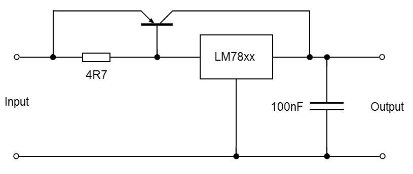

Does it have to ba a switching regulator?
If efficiency isn't important then you could go with linear but I wouldn't recommend it for 24V, at which point a switching regulator probably becomes cheaper.
A linear regulator such as the LM7805 can be boosted to supply 3A.
Right I think I've got the design down now... turns out I don't need 3A after all I was informed that I can use 1A with no ill effects.
I've added a diode (although not entirely sure what type to use) in to protect the circuit from the batteries being connected the wrong way round.
I've added in a 0.01uF capacitor for protection against spikes will that be sufficient?
I would recommend using more than 0.01µF (10nF), I wouldn't recommend using anything less than 100nF.
