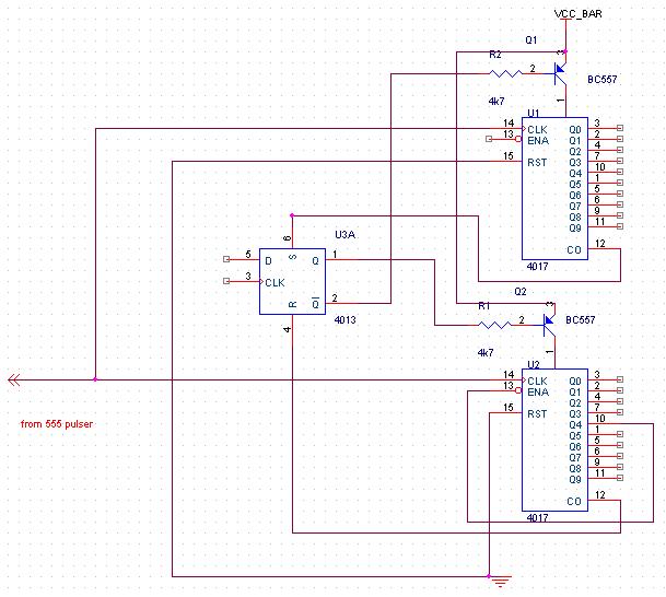

I'm trying to make a 16-step sequencer using the 10-step LED sequencer schematic that's out there which uses the 4017 decade counter IC. I've tried to cascade two 4017s together but the only things I can get it to do are:
1. one 4017 counts ones, the second one counts 10s
2. one 4017 advances one, then the other 4017 advances one (but has both steps on at the same time, which I don't want)
3. both 4017s simultaneously counting ones.
If I can get this thing to sequentially count to 20, I can shorten the steps to 16, which is *exactly* what I want. Help, please!! :(

hmm. well you could tryfinding a "flip flop" thingy.. what you need is somethign that will switch thesignal away fom the first 4107 and to the seccond 4017. as how to do that, i ahve no clue ;) Anyone else?
ok, i see this in 2 chioces.
1. you use a binary counter to 16 and a 4 to 16 line decoder.
2. use the 2 4017 with a 4013 flip flop
check the schematic

Wow, thanks so much! I haven't had a chance to put this together yet because I need a larger breadboard (I have the smallest...and cheapest...one I could get). I'll probably pick another one up tonight or tomorrow and report back :D

well.....you though of it, and i drew the schematic.

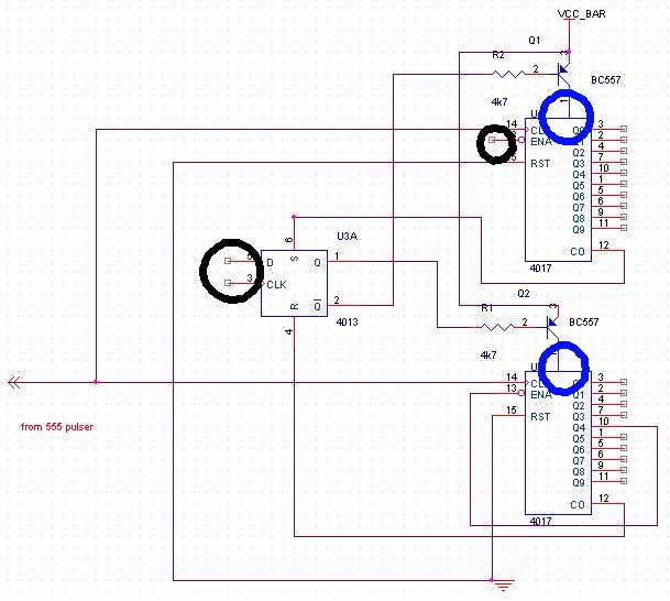

Ok, I know I must be doing something wrong, and I know it's because there's a couple of things I don't understand about this schematic. I tried making it last night and it wouldn't work at all. The questions I have are this:
1. The areas I've circled with black...does that little square mean that those are connected to ground?
and
2. The areas I circled in blue...what pin on the 4017 is leg #1 of the transistor supposed to attach to?
Sorry if these things should be obvious...I guess I'm not as good at reading schematics as I thought I was :oops:

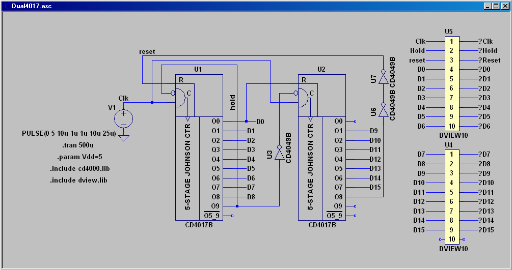

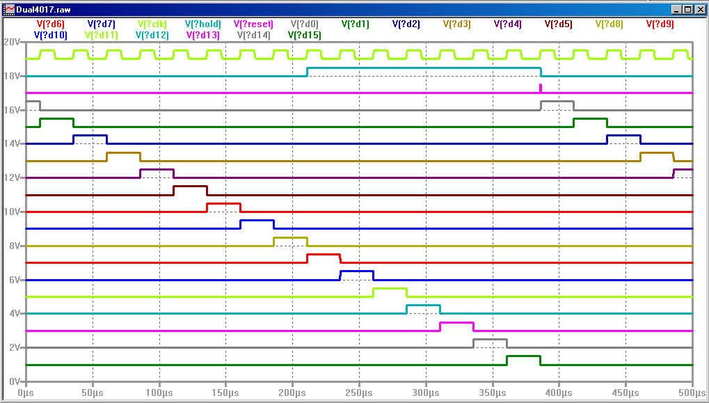

This seems to work. You will have to add a hex inverter to the two 4017s. I',m using two of them as delay pulse stretcher.
The first 4017 counts Q0 to Q8. (nine states). Upon reaching state Q9, it gates off its own clock, and the inverter enables the clock for the second 4017. State Q0 of the first 4017 always resets the second, just to get the two counters in sync. State Q8 of the second counter resets the first counter, and indirectly resets itself. Note that Q0 of the second counter is not used.
