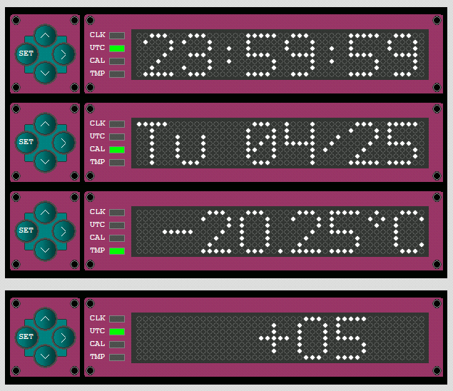

Hi Steve,
Yes, you can multiplex your 8 digit display using two chips (but more I/O lines)... Or you could use three chips and four I/O lines... Multiplexing requires moving the display driver into an Interrupt Service Routine which may sound intimidating but is actually simpler than the example driver I sent you awhile back... It also allows you to drive much larger matrices like the one pictured below with just a half dozen chips...
Have fun... Mike
