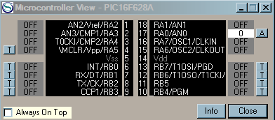

I've started using my pics today again, after about 2 months. I've compiled a small program just to refresh my memory again. Its a simple flashing led. It works fine, but when I add the command BTFSS it seems that the pic gets stuck there. No matter what I do, I can't get the pic to read the status on a port. The pic react as if the switch is open. I've added a 10k from the supply to RA0, and the switch from RA0 to ground.
Any help would be great
Here's the code

You have set AN0 as an analog input.:)

Hi
Thanks I forgot about the comparators. I've added these 2 lines before the setup of the I/O according to the datasheet.
MOVLW	0X07
MOVWF	CMCON
Now its works perfect.
What I don't understand though, is that I never really added those lines to the program before, yet it still worked most times.
