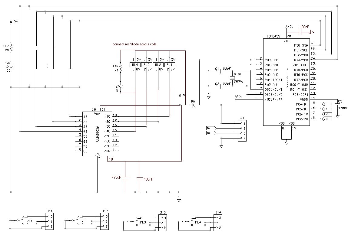

Here's the same thing, using the ULN2803A IC.
I've ordered some from the 'net so expect to have them in a day or two - they are 18pin ICs. Does the following schematic look ok?
Thanks again for any and all help with this - since looking up flyback diode on Google, I've found loads of pages that show how to drive a relay from a PIC, including the transistor, diode, resistor layout: before I was given this keyword, I thought I was on my own with this one!
I much prefer the ULN2803A method. While I'm waiting for them to arrive, I can concentrate on my PCB layout. Obviously it'd help to know that the schematic is correct before I do so - once again, any help is appreciated. Thanks!
The ULN sinks current, it cannot source current to drive a relay.
Pin 10 of the ULN has to be connected to the +5V rail.
EDIT:
I dont see any decoupling capacitors on the circuit diagram.?
Got it - like the earlier examples, putting the transistors on the 0v pin of the relays?
Look at this edit.
Connect the res/leds across the coils.
EDIT: what is the minimum operate voltage of the relays.???

I think this is pretty much the same as you've posted, Eric.
I've been working on the updated schematic so only saw your reply when I'd finished it. Pin 10 of the ULN appears at the top of the IC in my schematic - it's the way my software draws the components - and this is connected to 5v supply. Through trial and error I've found that the relays will switch over when 4V or more is applied to the coil. I've added in some decoupling capacitors with the ratings you recommended.
Am I nearly there yet?
