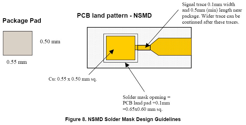

I also thought about extending the pads, but freescale has a special PCB land pattern guideline:
"Signal traces with 0.1mm width and
min. 0.5mm length for all PCB land pad near package
are recommended as shown in Figure 8 and
Figure 9. Wider trace can be continued after the
0.5mm zone."
But you think I can safely ignore this and just extend the pads?
