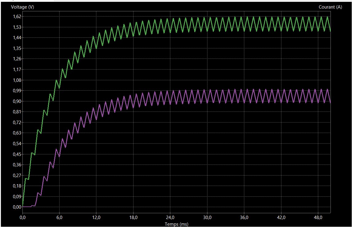

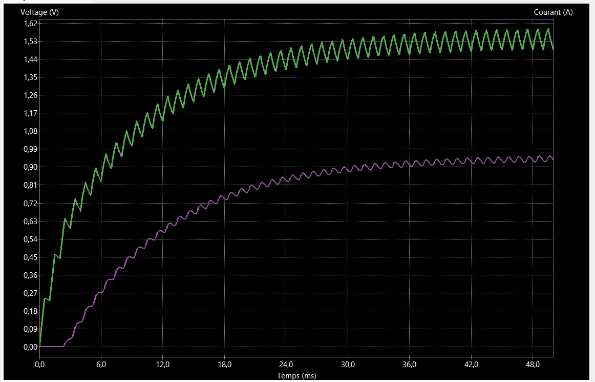

"Replacing R6 with a Schottky diode changes the circuit into a peak detector." You are right ChrisP58, this is absurd! I've made a simulation using Kicad pulse voltage source then Schottky circuit :
The Out signal clamp at Vf diode at 0.8V:
With or without Capacitor :

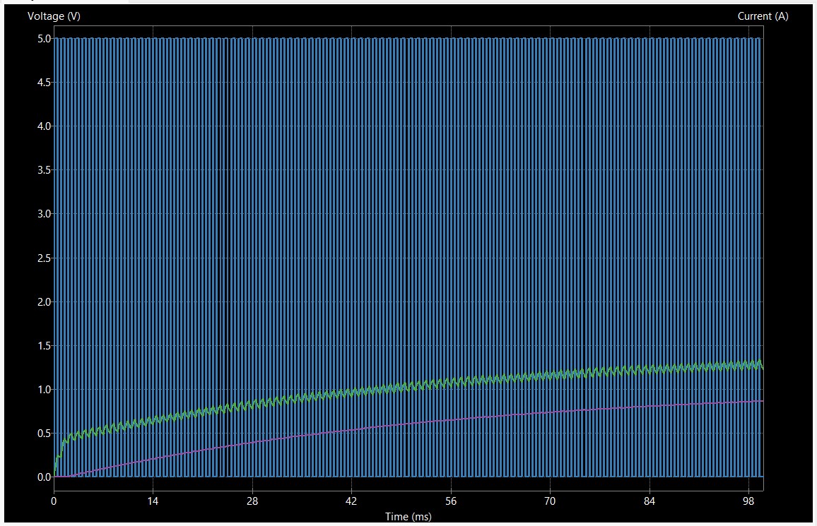

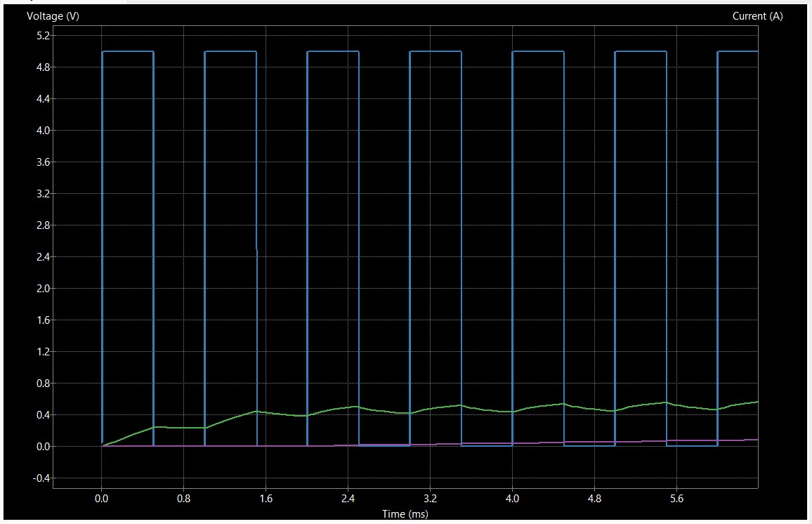

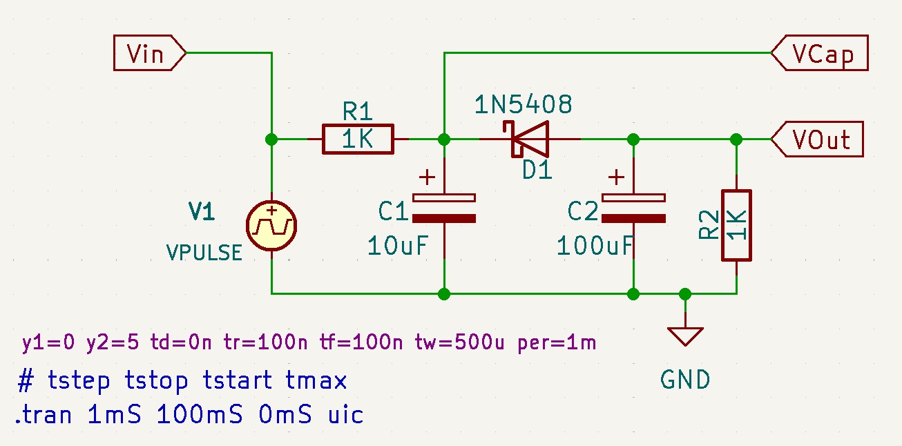

View attachment 147368View attachment 147369View attachment 147370
View attachment 147373View attachment 147372
George, did you know the stepper motor reference?
Your test circuit does not match the OP's circuit, so the results of the simulation does not give any applicable information.

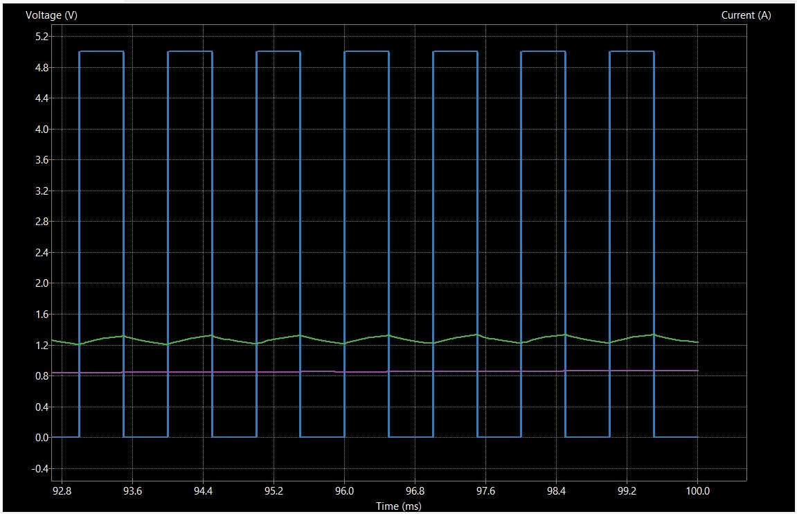

George, this is just for information, for your personal learning, your circuit is more simpler:
Here are the results with a duty-cycle of 10%, 50%and 90%, but again, this is just for information ...
