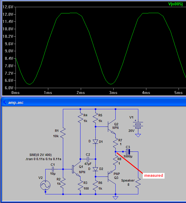

The problem is with your emitter follower, Q2. You have attempted to bias the emitter at approx. half the supply voltage, but the 8 ohm resistor nearly shorts the emitter to ground. This also drags down the base voltage, because your base bias network cannot supply enough current to keep the base voltage up, and it lowers the input impedance for the positive half of your waveform, causing the distortion you see on the Q1 collector when C2 is in place. Delete the 8 ohm resistor and see what happens.
As I said before, it is not a good idea to drive a speaker with DC.
I've modified your circuit so it drives an 8:eek:hm: speaker with no problem.

You can drive a speaker with that, but the gain is low and I think the distortion will be high if you want enough power to actually hear it.
I tried adding negative feedback around the entire circuit and many other things but the output transistors do not have enough OOMPH.

The output transistors in the class-AB circuit don't have enough base current to drive an 8 ohm speaker properly.
Electromaster fixed the software bug that caused the temporary attachment quota problem.
Class C is used in radio circuits where an LC tuned circuit removes the harmonics that are caused. Class-C would cause severe distortion (lots of harmonics) in an audio amplifier.
Class-D amplifiers have a very complicated high frequency pulse-width-modulation switching circuit.
There are sites that host your schematics and pictures. Some of them have horrible pop-up ads. Some of them take forever to wake up.
Here is a simulation of Hero's modifications:

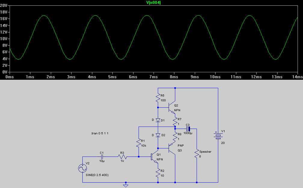

Here's a slightly improved version, it's not perfect or efficient but it has lower bias resistors for more power and negative feedback (provided by R1 to R3) to remove the distortion.

Hi Hero,
Your modified amp is much better.
Except its voltage gain is very low (2.6) and its input impedance is very low (about 2k).

That's what negative feedback does for you but at least it will drive the speaker, there's no distortion and you need to add a pre-amplifier to make this circuit useful.
You could make Q1 a darlington and R1 1M if you want more gain.

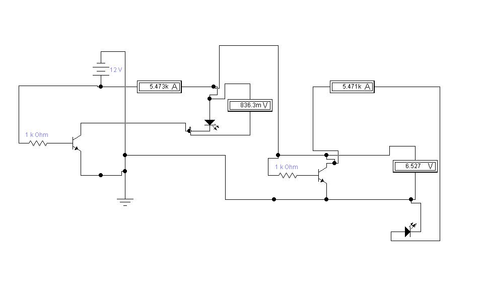

i have just downloaded the file couldnt get online all this time.listen here is a different transistor switch i found something like this in the forum.for the one on the left it was said that the led wud light if the base was driven low and for the right it was said that it would light when the base was driven high.i have measured the voltage and the currents as seen in the picture also can you tell me how its working.i understand the first one because npn sinks current correct me if i am wrong? and what is thje reason for the humangous current in the right hand side circuit??
No. The LED and the transistor would burn out as shown without a current-limiting resistor. The 10k resistor applies base current to the transistor to turn it on. Then the base is about +0.7V. If you connect the base to 0V then the transistor will turn off.
You had the LED connected directly across the battery so it would burn out instantly. You had the transistor connected so that it shorts the battery and burns out.
My corrected circuit shows a current-limiting resistor in series with the LEDs.
The circuit on the right has the transistor connected as an emitter-follower so that its emitter is about +11V as shown and if the base is connected to 0V then the transistor turns off.
Did you notice that on my schematic there are no wires running all over the place and no wires cross?
