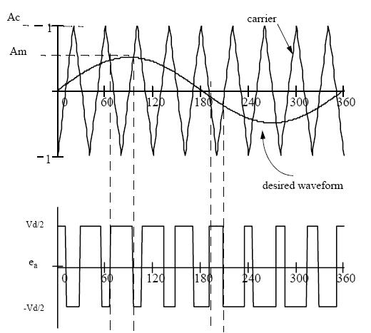

Please explain what is SPWM.
The TL494 has its duty-cycle controled by a DC input voltage.
The output AC voltage of the inverter can be rectified, attenuated and opto-coupled to the duty-cycle input of the voltage stepup TL494 for output voltage regulation.
Take a look at the attached JPEG file. It clearly explain what is SPWM. The bottom waveform is a SPWM where u can see that the duty cycle varies. Unlike PWM the duty cycle is fixed just like a square wave.

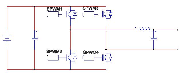

Using what circuit and FET? It is not typically a good idea to run high duty cycles.
Oh... I'm using MOSFET for my DC DC Boost Converter and IGBT for my DC AC Inverter.
My problem now is on the DC AC Inverter. It is a fact that the top and bottom switches cannot be turned on at the same time else short circuit will occurs due to deadtime. I have tried to put a slight delay for every turning on but it still give me the same deadtime problem when ever i increase the supply voltage.
Is there a good recommended way to implement the deadtime circuit? :)
Attached JPEG are the inverter design.
What frequency? most IGBTs are slow so you would need to make sure you have fast ones like IRFs warps. And at what load? They are even slower at low currents.
You like talking with letters so I looked up SPWM.
A TL494 PWM IC can make SPWM by inputting a sine-wave. It uses a triangle wave internally and comparators to create the vaying pulse widths exactly like your circuit does except it has more functions like adjustable dead time control and feedback.
Oh.. I'm using STGW19NC60WD_IGBT and it datasheet states that it is an ultrafast powerMESH IGBT and it turning on/off time is just a few nanosec.
Actually, no matter how fast the IGBT is switching.. it will have a crossing point between the upper and lower switch when turning on/off. Thus, deadtime occurs...

You are confusing "shoot-through" with "deadtime".
Shoot-through is when the upper and lower transistors are turned on at the same time when one is turning off and the other is turning on. A very high current shoots through from the power supply to ground.
Deadtime is the fix for shoot-through because deatime is a pause when both transistors are turned off for a moment so that one can completely turn off before the other turns on.
Look at the datasheet for the TL494 and it is shown. All PWM ICs have a deadtime.
Are you trying to make your own PWM controller IC?
lolx.. thanks for telling me the term "shoot-through"... In our sch, the lecturer always said deadtime that why I said it deadtime... I'm designing PWM circuit not IC but I think it good to give it a try on just a single IC as the power consumption and noise will greatly reduced. :D:p:o
