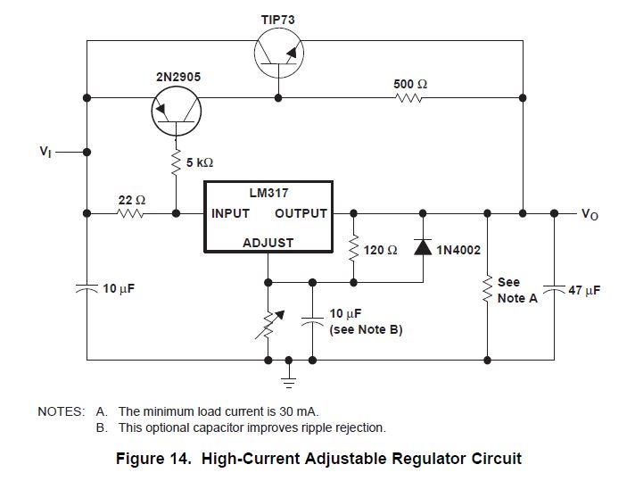

I seen this variation in an electronics mag years ago.
EDIT: This was meant to be a reply to post #20, I didn't realise there were so many more posts!
This is a circuit that I've actually built and tested. I used a bd140 for the PNP and a tip3055 for the NPN, so should be fine with a 2n3055. I believe the circuit originated from one of the old National Semiconductor data sheets or app notes for the LM317.
Thanks GB. This approach effectively converts the NPN power transistor into a PNP transistor. One minor problem is that the loop gain is pretty high and you have to be aware of frequency stability. But once you get that sorted, the performance would be pretty good.

Perhaps I led you astray. The forward voltage drop of a normal silicon junction diode is around 0.6V at a low current, taking into account the current rating of the diode, that is. This would be at 25 Deg C. The forward voltage drops by 2mV per degrees C. A Schottky diode is the same except its forward voltage is around 0.4V, and even as low as 0.3V for some high conductivity types. That is why Schottky diodes make more efficient rectifiers. Schottky diodes are also fast so they are always used in switch mode power supplies, which operate at a relatively high frequency (10KHz to 4MHz).
The problems with putting two diodes in series with the output of an LM317, in order to get zero volts are:
(1) The forward drop of the two diodes would vary with temperature, so the output voltage of the PSU would vary with temperature.
(2) The forward drop of the two diodes would vary with current, so the output voltage of the PSU would vary with current drain from the PSU.
(3) The forward drop would vary from diode to diode, so you would not exactly cancel the 1.25V nominal reference voltage of the LM317, especially as the LM317 reference voltage varies from one LM317 to another anyway.
(4) There are more complex reasons why the two diode approach would not be satisfactory, but it would take too many words to explain.
Having said all that, ordinary diodes (1N4148, 1N400x) are used as voltage references in circuits.

There are hundreds of power bipolar junction transistors (BJTs) that outperform the 2N3055/MJ2955.
The 2N3055/MJ2955 suffer from the following shortcomings:
(1) Current gain falls off badly after about 4A
(2) High thermal resistance, junction/case, of 1.5 DCW
(4) High saturation voltage, collector/emitter
(5) High base/emitter voltage
(6) Low, frequency response of 300KHz and 2.5MHz, depending on which version of the 2N3055 you get.
(7) Relatively low (for a power transistor) collector/emitter voltage of 70V
(8) Relatively limited SOA
The TIP3055/TIP2955 are plastic case versions of the 2N3055/MJ2955, but there are some differences in the specification and in my opinion the TIP35C/TIP36C would be a better substitute.
The ON Semiconductor, MJ15003G/MJ15004G, are generally considered to be the the modern replacements for the 2N3055/MJ2955.
A really nice pair of transistors are the, MJL3281A/MJL1302A (just look at the flatness of the current gain graph).:)
And if you want to handle some serious current and power, the MAG6332/MG9412 are the boys.:D
