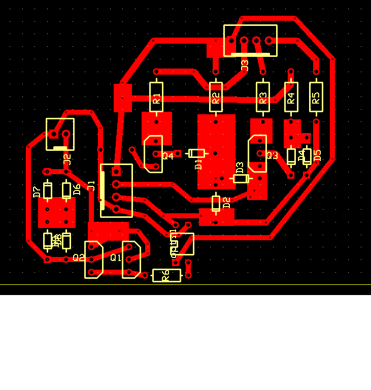

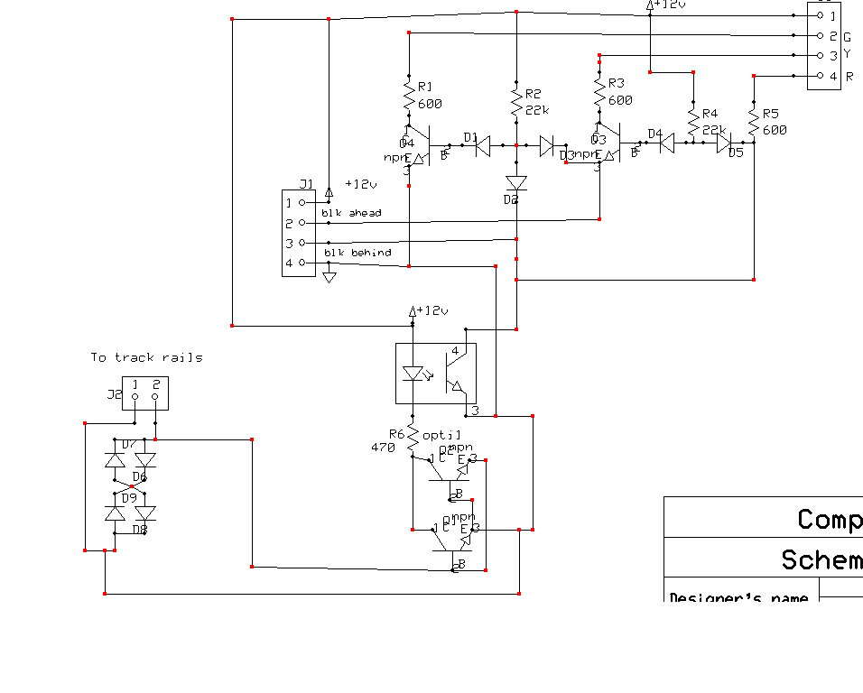

circuit board and schematic
just copy, print then take to a phgoto copy machine and print on glossy photo paper.
iron onto CLEAN copper board.
etch then drill
I put a bridge rectifier instead of separate diodes.
probally take less space if I did the separate diodes.

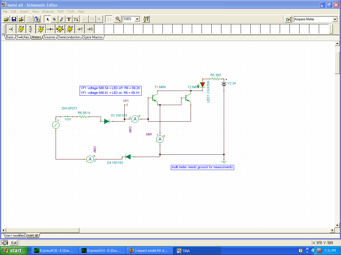

An N guage loco draws about 0.5A. As I have no idea how resistors will affect current I don't know what difference a 0.5A loco plus 10 wagons, with 5K resistors on one axle of each, will make.
TINA says the resistance is ok with 10 wagons. Not sure how to sim a 0.5A loco though.
Edit:
Just added a 0.5A 12V (6W) motor across with the resistors for 10 wagons and it works, in sim at least.

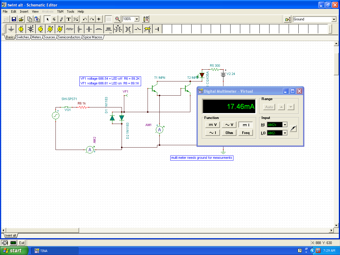

No, no. Connect a pair of power diodes, in parallel and back to bacK between T1s base (that is also T2s emitter) and ground. i.e take out the bridge and put in the diode pair. That way there is only one diode in the each half cycle's current path. This asures a max voltage of 0.7 volts (or maybe a bit less) across the PN junctions of each Twin-t transistor.

Mr Mneary,
The current for the engine passes from the the DCC booster, across the track through the engine, through a shorted bridge rectifier (two heavy duty diodes in series for each half DCC cycle) and back to the dcc Booster.
The diodes, when conducting, provide a maximum voltage of 0.7 volts each (1.4 volts total) across the two back to back base/emitter junctions of the Twin-T transistors. i.e Most of the engine+car current passes through the two power diodes, allowing signal transistors to be used for the detectors (Twin-T)
yo Railway Pete, draw me a picture of what you want.
You really should download TINA 7 not 8
its free and not a bad simprogram.
I use LT SPICE as well as TINA.
if both come up with same results then am pretty safe it will not creat magic smoke on building actual circuit. But then there's Murphys Law
hope ths is what you are wanting?
I changed the resistor to a 1 K
17ma current draw

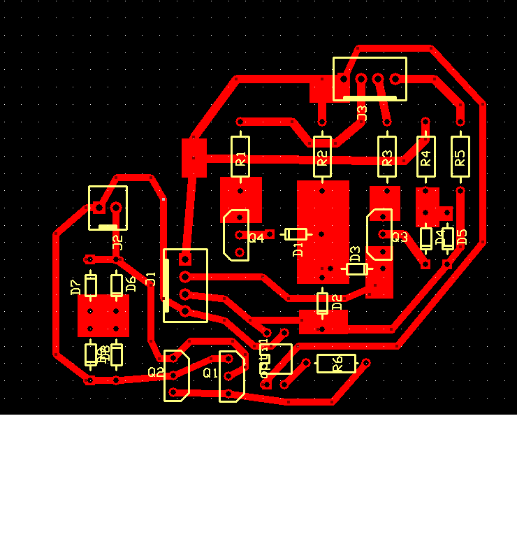

updated pc board (I missed a connection

OK, here is a diagramatic explanation. Just replace the brige rectifier (4 diodes with two 2 amp power diodes.
  • Bridge equivalents.pdf
17ma current draw
Just to check.
1/ Which resistor are you talking about? Is it the one across the track? Is that the maximum value that the circuit allows before the Twin-T drop out?
I suggest you start with an 8 ohm resistor (at 2 amps DCC track current) and increase its value until the Twin -T drop s out. That should be the resistance across the axles of Angie's cars.
2/ Your PC card is nice but the high current carrying foils (Track current)should be much wider (3x would be OK).
3/ The LED in the common collector of the Twin-T should have a resistor of about 1K in series with it. (or is that the resistor you are talking about?)

Angie,
I'd like to know what kind of error. Pls make sure that the diodes are back to back. If not then all of the DCC current will be diverted through a signal transistors PN junction during one half AC cycle of the DCC booster's output. Smoke!. A short should not cause an error. The circuit just won't work.
Please check to see if you have created an open circuit during half of a DCC AC cycle.
Also I sent a diagramatic explanation to MrDEb. You can check that out too.
If you just took out two diodes from the PC board diagram and have not replaced them with a jumper All the DCC power will try and go through the little teeny Twin-T transistors.

The signal transistors will receive 1.4V on their bases, which will force a lot more than a token current into the base. With one diode drop, the problem is less serious, but it depends heavily on the Vbe and base resistance of the transistor. A base resistor of a few hundred ohms would do no harm and would improve transistor life dramatically.
