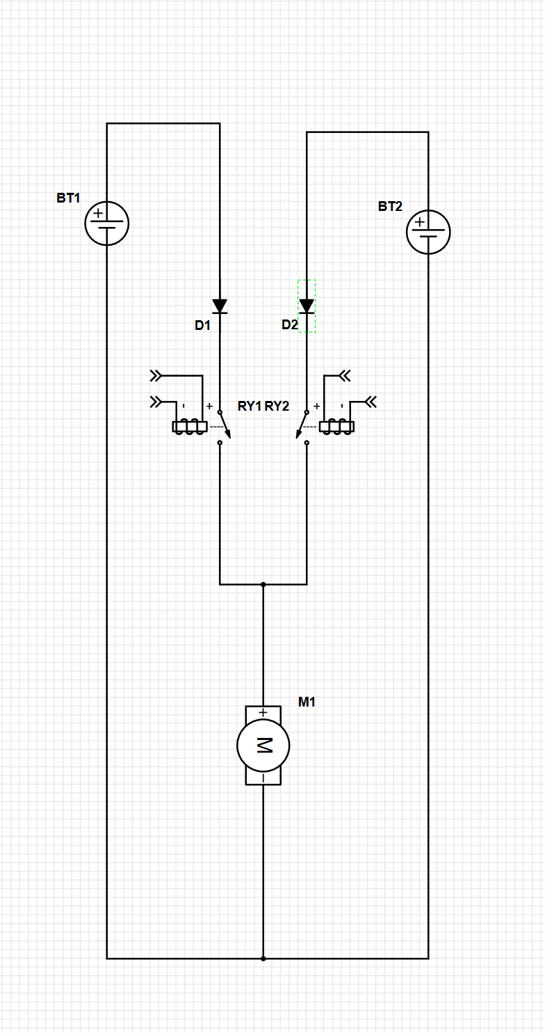

I want to be able to control my lawn sprinklers from two different switches. 24v turns the sprinklers on. The first one being the regular sprinkler timer control box that is already installed on the side of the house (let's just call this the "control box"). The second being a pool automation base (it's a Hayward Omnilogic pool automation base, let's call this "Omnilogic") which has 24v relays I can turn on/off with my cell phone as it's networked with my home network.
The reason I want to be able to turn them on from either the control box or the Omnilogic is so the lawn maintenance guys can still set the timers from the control box they are use to using but then I also have the ability to turn the sprinklers on with my cell phone through the Omnilogic. I do not need to be able to turn them off with my cell phone if the timer has turned them on or be able to turn them off with the timer if the Omnilogic turned them on. In other words, what I think I need is a 3-way switch that allows 24v to pass through to switch the sprinklers on when either the control box or the Omnilogic is on but not double up the voltage if both are on. I think a 3-way relay would accomplish this purpose. Am I thinking of this correctly?
What switch would I need? I would like it to be as small as possible as I will leave them inside the control box. I have some soldering skills, so I can solder the connections if I need to.

Oh wait, you want to be able to override things with your phone? Then you need something a bit different than wiring multiple relay primary contacts in parallel and running the coils to separate control sources. Doing it that way means any control source can turn it on, and as long as one or more are commanding it to be on, it will stay on. It cannot be turned off unless all control sources say that it is turned off. The simplest way to override is to add in another relay in series with all the parallel primary relay contacts that can disconnect everything.

I need to verify something. You say the system has 24V relays. Do these relays actually connect to the 24V battery? Or are they just contacts that connect two points together than can handle 24V? There's a difference.

As we discussed in chat:
The timer box and Omnilogic box each have one primary contact permanently connected to their own 24V source.
No external relays needed. Can use relays internal to boxes.
Only need to override things to be ON.
Override to turn things off not needed.

Sprinkler systems often operate from 24Vac.
Are we talking AC or DC here?
He said they were being powered from batteries being charged from the line. But yeah, if AC, you can't mix unless they are in sync and equal (identical). Also no diodes. Best to disconnect one before connecting the other in that case.
