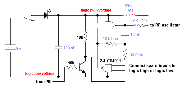

While waiting for the smt parts, I tired to modify the 'crappy' rf module. I'm using a CMOS NAND gate for the transmitter, when I pull up one input of the NAND gate with a 10 k:ohm:, it doesn't oscillate as expected. So I turn the transmitter on and off using a transistor by PIC. It works at the bit rate of 10 ms. I'm still learning the method of coding and decoding, this is what I can do so far.
I wonder why I can't modulate from the logic gate..
Do the Cmos gated oscillator like this:
Any NPN transistor will do right? I'll use 2N3904 for this. If I do it this way, can the bit rate be faster? But I don't know whether the poor receiver can receive as fast as the transmitter do or not.
I think the LM567 in the receiver is slow. Its max switching speed is f0/20. f0 is about 7kHz so the switching speed is 350Hz.

audioguru said:
I think the transistor is the 300MHz oscillator and it is turned on and off at an audio frequency by the classic Cmos oscillator made from two Nand gates.
The Cmos oscillator can be stopped by diconnecting the input of one gate from the circuit and grounding it, then started with a resistor that pulls the input high.

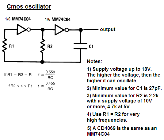

How do I calculate the frequency of the Cmos oscillator?
Why I can't do it like mentioned previously, just add a pull up resistor. From your schematic, the transistor also acts as a switch right?
The flux basically 'floats' to the top of the soldering joint once the solder hits it and leave a residue over the top of the joint, some types of flux leave a corrosive residue which needs to be cleaned off afterwards. Depends on the flux.
The Cmos oscillator turns on the transmitter and turns it off. Then the modulation is digital AM.
The calculation for a classic Cmos oscillator is here:
bananasiong said:
Where are the values from? 0.559 and 0.455.
MM is an IC prefix used by National Semiconductor so it might have been on their applications note. The same formula is in my "Cmos Cookbook" written by Don Lancaster.
From the attachment, it says that if the supply is higher, the higher it can oscillate, means frequency?

A Cmos inverter or gate has a higher output current with a higher supply voltage so it can switch faster. I use a two-inverters Cmos oscillator at 1.6MHz on a 12V supply and it works well.
