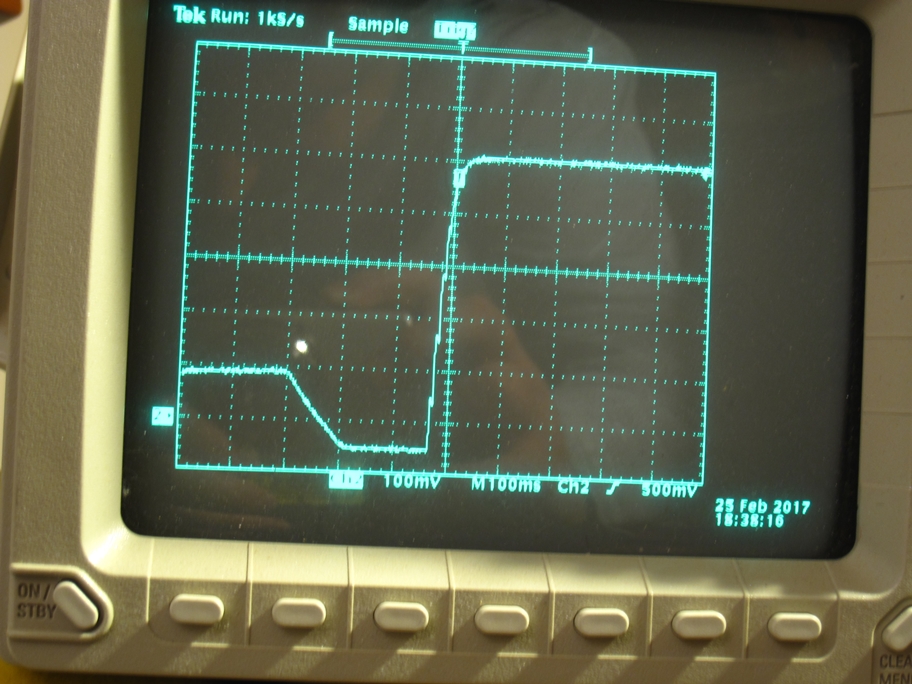

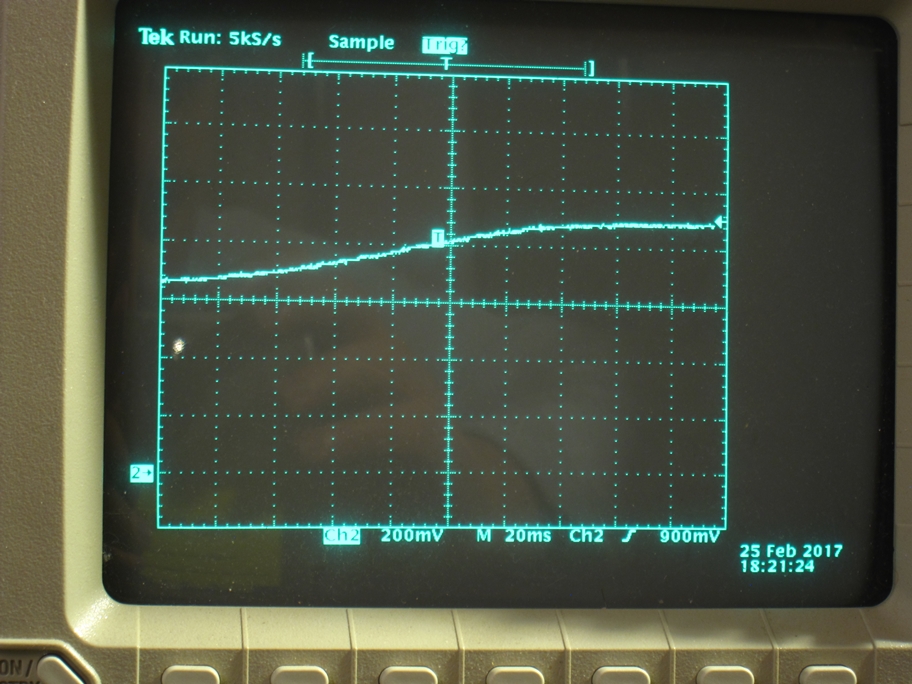

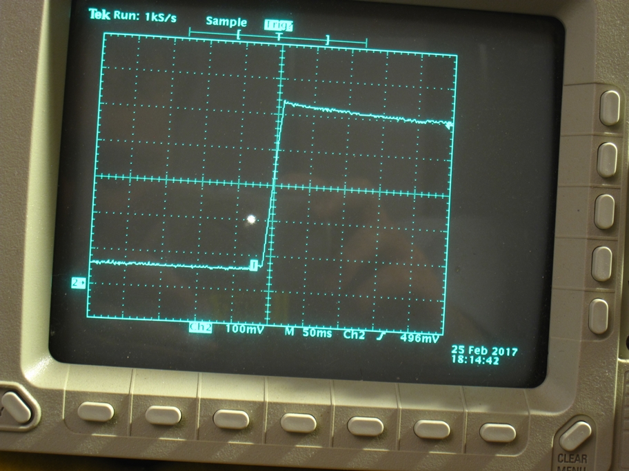

If you have an oscilloscope with one-shot storage, I would also want to carefully characterize it's turn-on, voltage switching, and steady-state behavior for overshoot transients, rise time, and ripple, which are important characteristics in a power supply if you intend to use this for more than just basic short testing. You will probably want to look at these behaviors both for an open-circuit and under load. If you have a non-storage analog scope, you should at least still measure the ripple. You will also want to keep a close eye on the temperatures to make sure those heatsinks aren't getting too hot under load.

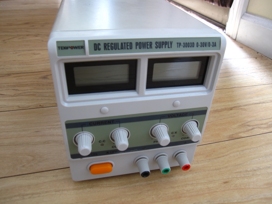

Hi G69,
Go for the 0V to 30V, 0A to 10A linear variable power supply- why mess about with anything else?
I gather that you are put off by the seeming complexity, but those power supplies are dead simple to use: just plug the power supply in to your mains, set the output volts to whatever you want and the current to whatever maximum current you want and that is that. You can even use the power supply as an an automobile battery charger if you ever need to.
By the way, if you think that the current setting forces that current through the load, that is not correct. The current setting is just the maximum current that the power supply will supply.
For example if you set the output volts to 12V and the output current to 10A and connected a 6 Ohm resistor across the output terminals of the power supply, only 12V/6 Ohms = 2 Amps would flow (just the same as a 24 Watt bulb). If you subsequently shorted out the terminals of the power supply, only 10 Amps would flow and the power supply would not be damaged.
Just think of the power supply as an adjustable voltage battery.

Yes it does make more sense than to complicate my life building that other stuff even though that display is really appealing and innovative , and I want it just for electronic testing in particular(well for starters) to pinpoint shorts that I cannot detect by measuring components.
