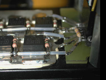

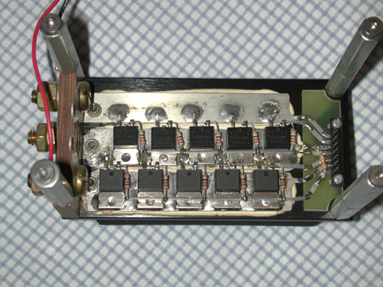

I was considering soldering several mosfets in parallel. Can all the 1 pins be soldered in parallel? Can all the 3 pins be soldered in parallel too? Is it that easy?
Solder the 3 pins in parallel. Use a separate gate resistor for each 1 pins (gate) (think of parallel led's) Use something around 10 to 22 Ω for the gate resistors.
