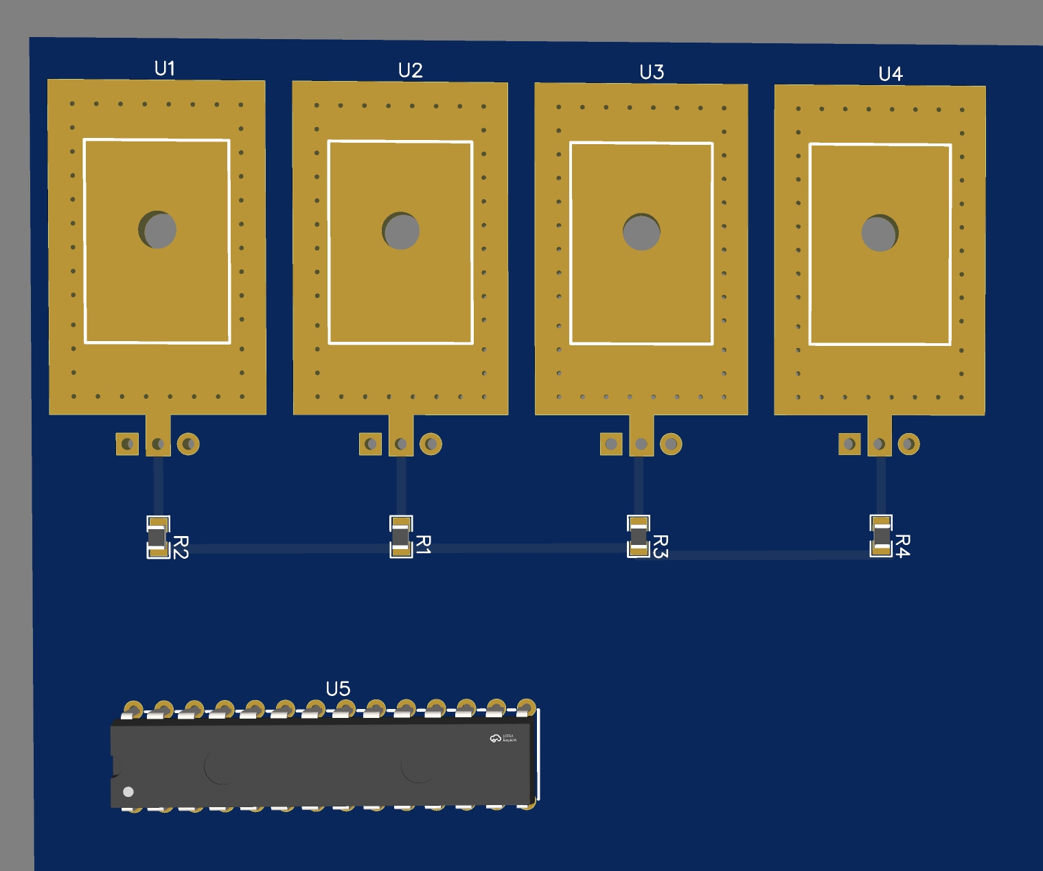

I want to attach all 8 tabs to the circuit board as heat sink but can I attach all 8 on together on the circuit board?
Here is a revised footprint that does work. No DRC errors or other issues.
  • PCBLIB_PCBLIB_TO-220 HORIZONTAL_2024-04-12 + HEATSINK-TEST6_2024-04-18 (2).zip
If the via stitching is to improve heat transfer from the top to the bottom layer, it would be better for them to be close to the heat source.
As shown above, the thermal path from the device to the center of the bottom pad is relatively long. Putting the vias under the device will make the bottom area much more efficient.
There will be a lot of heat conducted by the bolt, but if you're adding vias, they should be placed where they will do the most good.
Good point, but I'm reluctant to put vias under the tab so as to provide the smoothest surface under the tab.

So you didn't even try my revised footprint? That I spent a couple hours working on on your behalf?
Guess I know when to cut my losses.

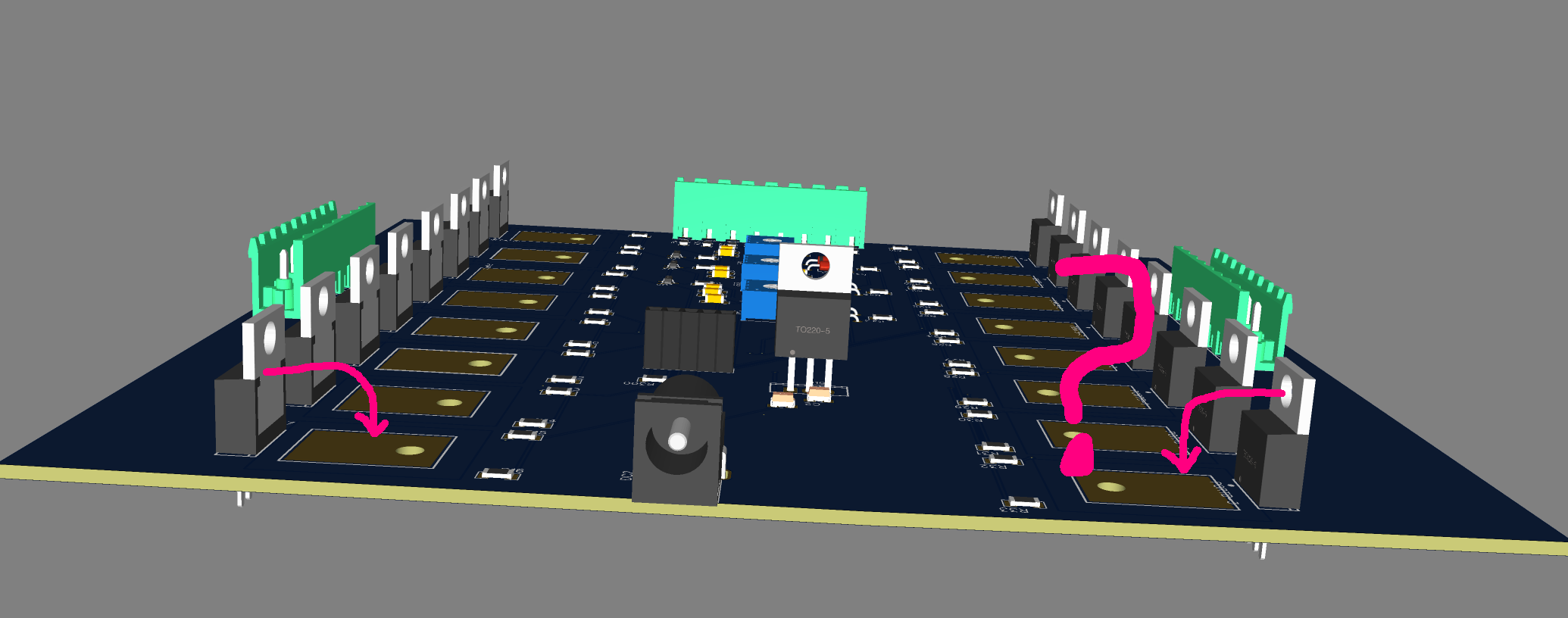

Not that I give a rat's a$$, but I don't think your board is going to work very well. I don't think I'd run three traces between the pads on 1206 resistors (and there are many places where clearance is really tight where's there's no need) but that's not the fatal flaw.......

Works fine for me, using the footprint in post #121. The pictures are YOUR board, with my footprint.
You apparently don't see the problem in post #127. That's your board. What happens when you bend the MOSFETs over?
Just making a guess as im only just learning this stuff. Is the problem you mention, right hand side will have plastic on the foot print doodha, and the other side has what looks metal to metal? so bending them on right (if Ive read this thread correctly) going to be no point bending plastic onto metal for cooling?? Or am I missing something obv ios?

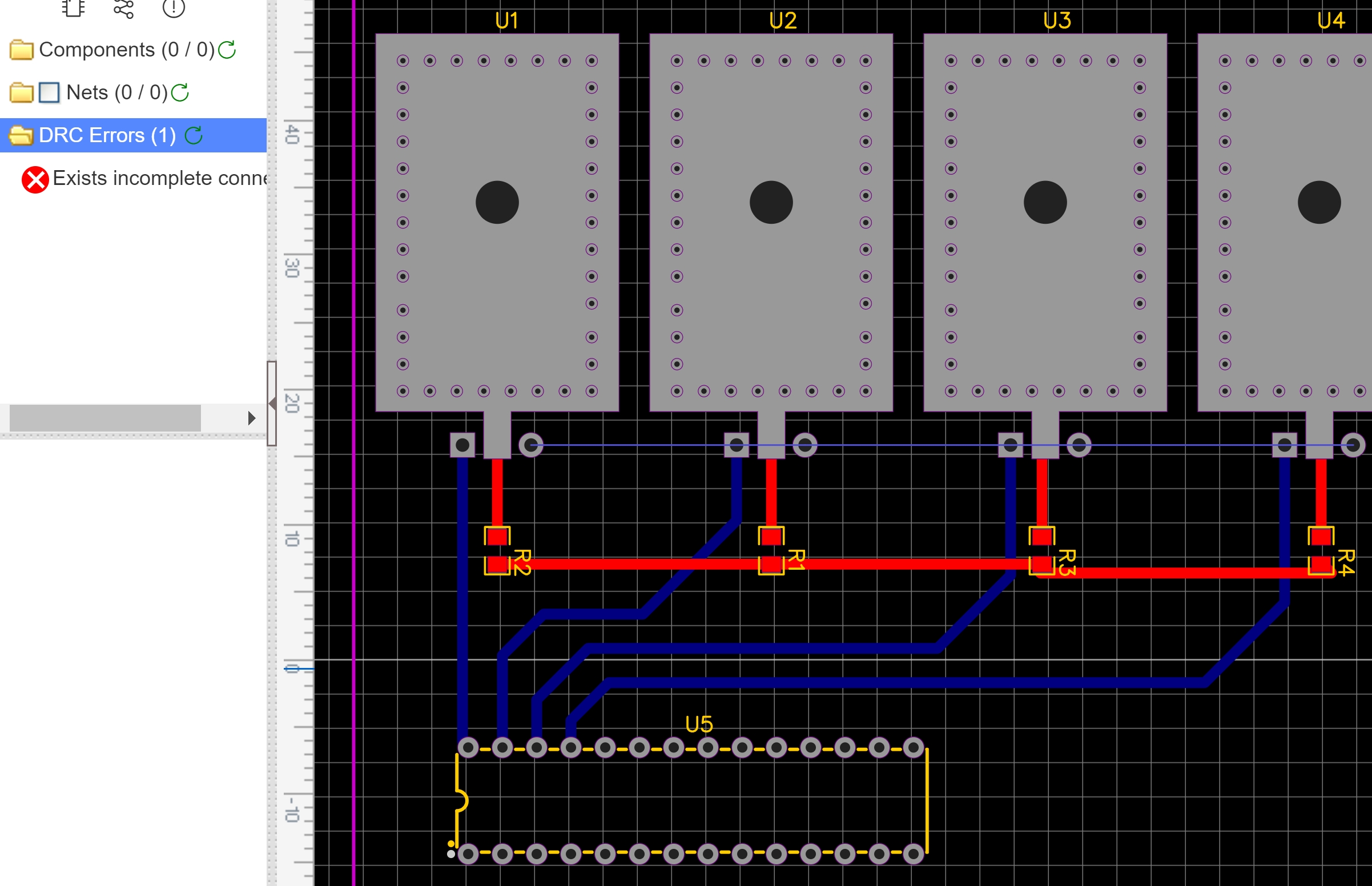

I corrected the mosfet layouts and pasted the footprint from post#121.
Everythig going well until I ran the DRC. The standard edition of easyeda has numerous issues like freezing up.
Downloaded the pro version and going to try it out. Maybe it will work?
Sorry you're having issues. I have experienced very few problems with the standard version of EasyEDA. I don't use the pro version because it doesn't have some of the features I use in the standard version.
You should ask for help in the EasyEDA forum if you're having problems with EasyEDA.
Are the errors indicated legitimate?
