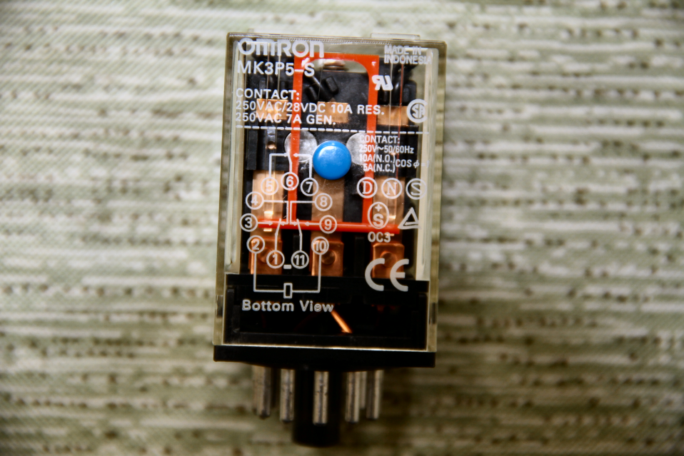

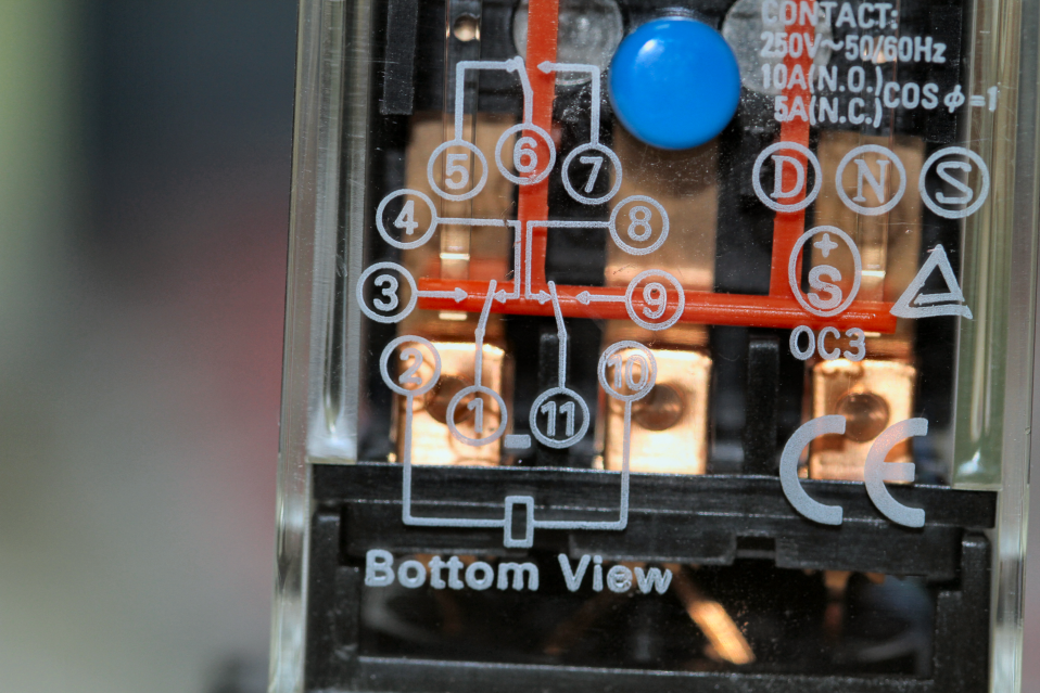

While the models vary slightly with features the pin out was the problem. Attached are a few images of an Omron MK3P5-S which is a 3 Pole Double Throw 12 volt coil relay. Though not identical to yours as to features it functions identically. Note the pin out. This is the relay you have. and this is the data sheet for the relay you have.
Now if you scroll to the bottom of the data sheet we will see where the problem was. Note the pin out for the MKS3P(I) which is identical to what you have. Now note the pin out for the MKS3P(I)-5. The latter is the pin out for the relay I used in my circuits. I even included a pin out drawing. There was nothing wrong with my circuit, the problem was that you had a relay with a different pin out. While there was a my bad in there I would have thought you would have caught the pin out difference, it's on the relay. :)
I am pleased it finally works as advertised. Now wasn't that fun? I am even more pleased we now both understand why my drawing wasn't working with your relay. :)
