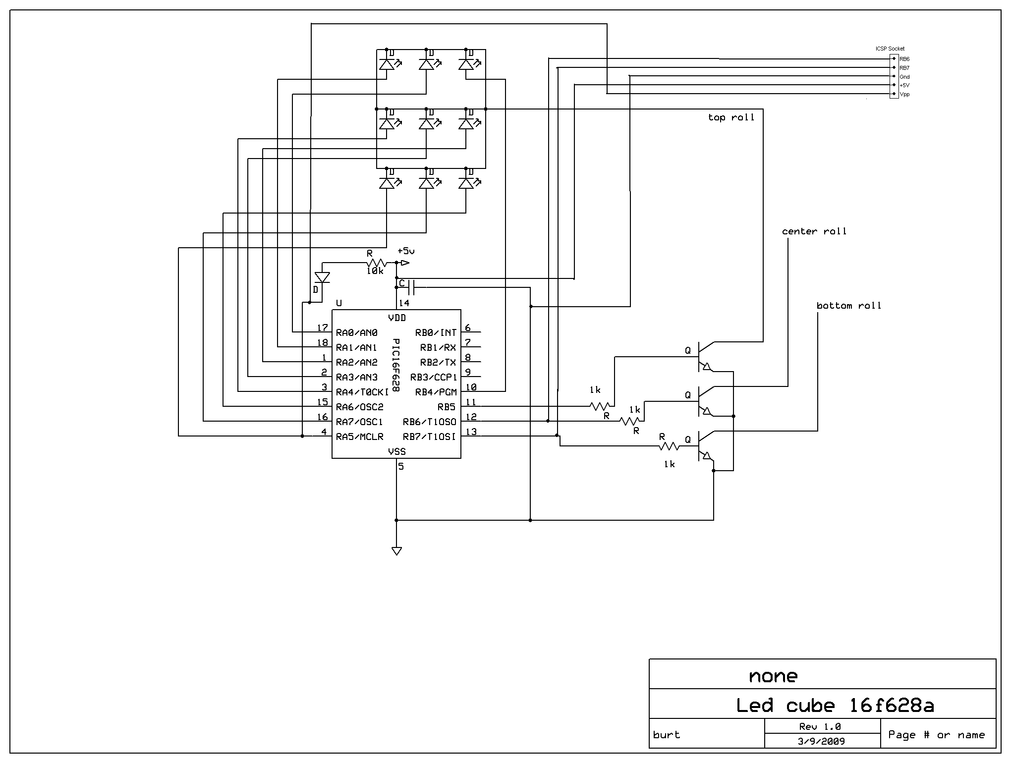

Hey folks, I am also trying to create this cube with the PIC 16F628 and i have went through all the pages of this thread and downloaded all the files.
It seems that every asm/hex file and every schematic has slight variations with respect to the LED lines.
Can someone point me to the correct combination that will work :)
I appreciate it !!
Pete
It's not that hard there one pin on the 16F628 that's can't output 5 volts and thats what made this thread so long lol.
I no longer have code for this but I was going to make a blue one when my leds get here. I'll post working code this week if you want.
Thank you so much for your response Burt !!
Perhaps this may be helpful then and save double work, i have downloaded and attached the unique files on this thread asm/schematics.
If you can point me in the right direction id really appreciate it, id like to make a few boards/cubes as gifts for some close people.
Pete

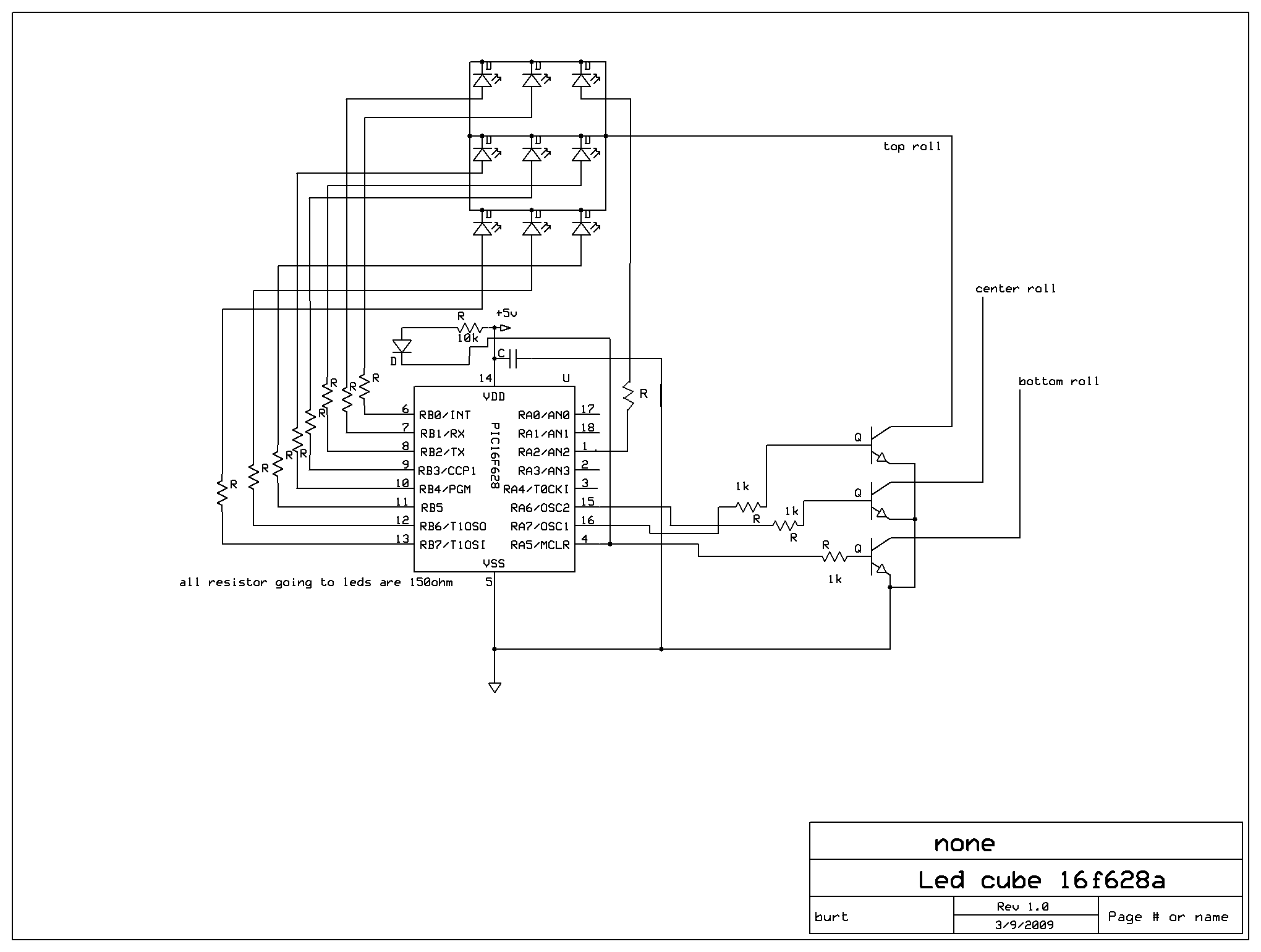

This will work
PORTA.2 turns on layer1
PORTA.6 turns on layer2
PORTA.7 turns on layer3
PORTB 0 to 7 are led's 1 to 8 and PORTA.3 is led 9
*Layer sink with a npn and portb sources the power to the Leds.
And this asm
  • Righ3x3x316f628a.asm
Much Appreciated Burt !!

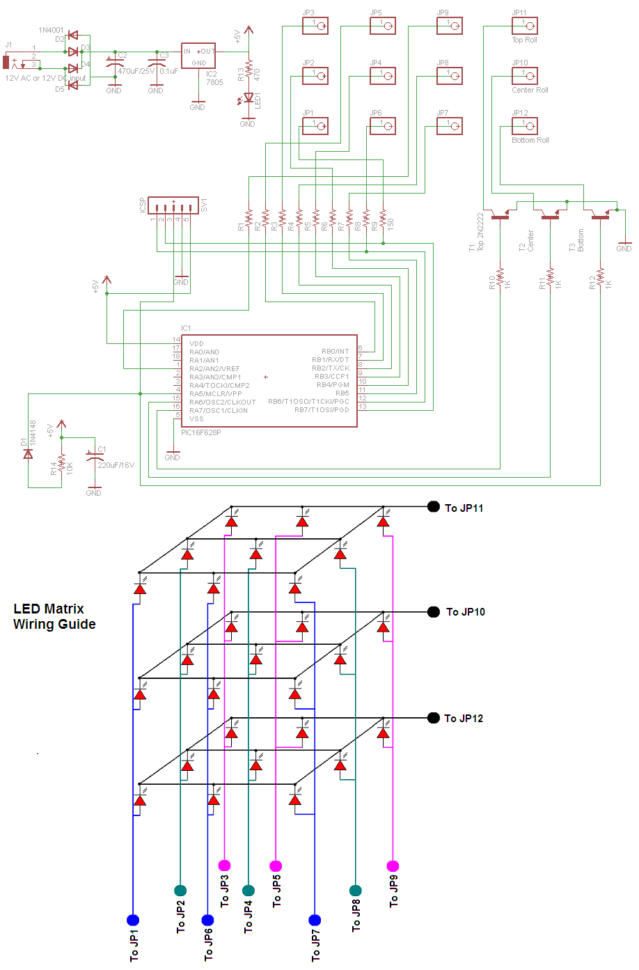

Does the schematic look right to you corresponding to the code given ?
Pete
  • 3x3x3 complete.pdf
Pete
Pete, could you write the values of all the external components Please.
Thank you.
Regards,
kv
I used 150 ohm on the leds and 1k on the npn
I looked on the other schematics and I think I got that part, I just wanted all the Values displayed on the final to make it easier to read, What value was C2 on VSS? I really like the 2 drawings in Post # 293
