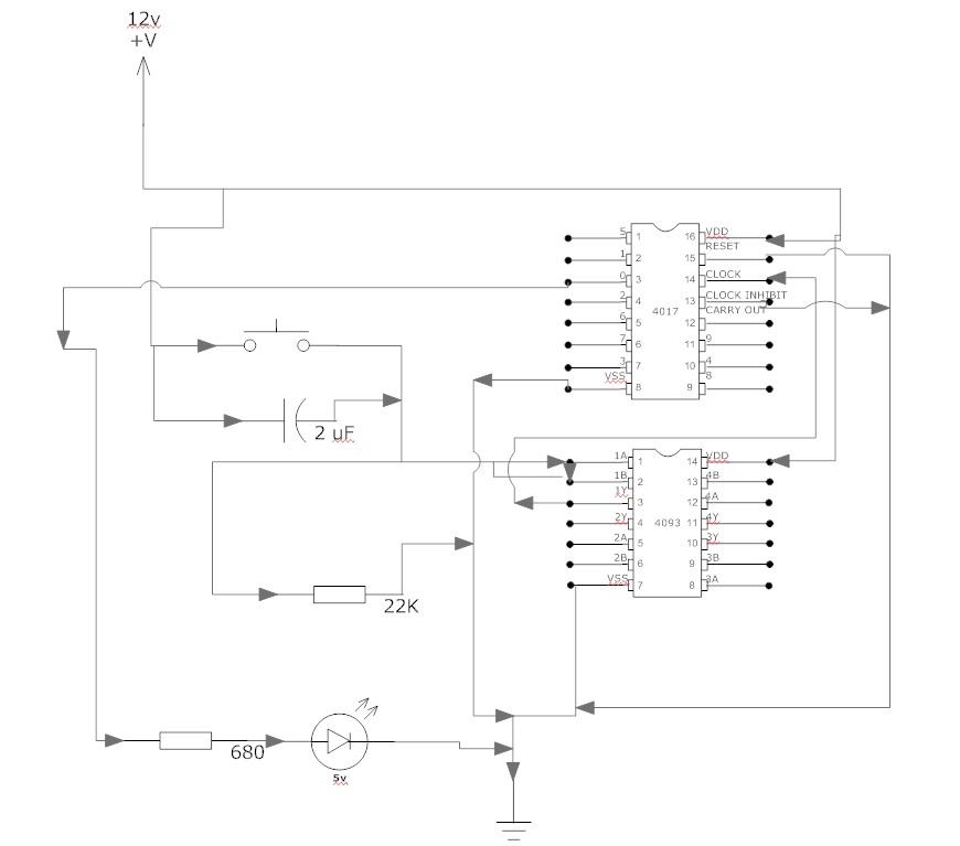

I've followed some websites:
https://www.electro-tech-online.com/custompdfs/2010/02/HEF4093B.pdf
So now I've created a new electrical scheme:
With this scheme, the counter should just advance to the next output when clicking the switch, and after output 9 returning to output 0 and start over again, right? Have I also fixed the bouncing problem with this scheme?

But did anyone already take a look at my new scheme, including the debouncer?
Do you have a push-button switch with Common, NormallyOpen, NormallyClosed (three terminals)?
No, it's a pulse switch, I assume you know what that is:P
just 2 contacts, normally open, press the switch and it's closed, release the switch and it returns to the "open" state.
So, 2 terminals.
So, 2 terminals.
Ok, let me rephrase it: GO GET a momentary pushbutton that has C,NO,NC and I will show you how to make a debounced switch. The one you posted doesn't solve the bounces.
