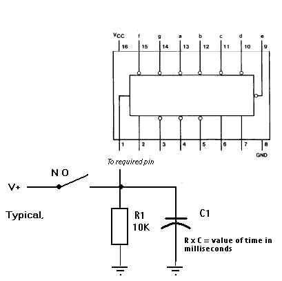

4017 clock input with a pulse switch.

But did anyone already take a look at my new scheme, including the debouncer?

Btw, another switch is definetely no option. This should work, according to the website manuals I followed. If it does NOT work, can you perhaps adjust my scheme so that it WILL debounce?
Thanks ;).
What program are you using for your schematic? Turn off the arrows (Looks strange), should be dots. Anyways, check out this link, very good article on switch bounce near the end it shows several methods to solve switch bounce.
http://www.ganssle.com/debouncing.pdf
Herre is a simple was to cover switch bounce. The RC constant allows the vibrations of the contacts time to dampen while the capacitor is charging.

That might work. Try it out. Looks pretty good!
Thanks allvol, your reply was very usefull =). I'll try it tomorrow if I've got the time to get the components from my local electronics shop. Though, your way is slightly different from my design. In my design, the resistor is a component which bypasses the 4017 chip after the switch, and the capacitor is parallel to the switch. In your design, the resistor as well as the capacitory bypasses the 4017 chip (makes more sense to me actually). If that doesn't work, I'll try my own design.

Anyways, I've tried AllVol's way, and it works!!! Thank you very much all =).

It isn't my way.... it is just another way of accomplishing something. It is one of the building blocks that you can use in many circuits. When you get into micro-processing, you'll use this same circuit often.
