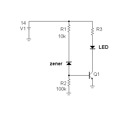

Hello again,
Here is the basic circuit. The resistors depend on what kind of LED you are using. That circuit is based on 20ma LEDs. If you have higher power LEDs we'd have to change a few values, so you'll have to state what kind of LEDs you are using.
Typical transistor is 2N2222A or similar for the 20ma LED and might work up to 350ma with change of base resistor (R1). Resistor R3 is your LED current limiting resistor that you must have already selected.
That zener is your 7v zener or similar.

great just a little more info for you which might change a few things
the leds are in a unit which is sealed and can take 4volts to 14volts so i think the we might not need a resistor as i think they are built in to led set

Ok then you may have to reduce the value of R1 to as low as 1k or so. You can check to make sure the transistor turns on fully by measuring the voltage from collector to emitter and it should be around 0.5 or even less.
Hello again,
Yes R2 can stay the same unless you use a bigger transistor and then lower it to 10k. You can use 10k with a smaller transistor too if you like.

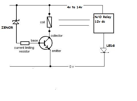

Can the leds go after Q1 because i have 3 sets of leds and one -ve in the pack
3 +ve and one -ve for the set

would this work
would this work
the relay uses about 150ma for the coil
Can you modify the original switching circuit by removing the resistor which supplied the reduced current to the orginal lamp? It likely is wired across the switch.
