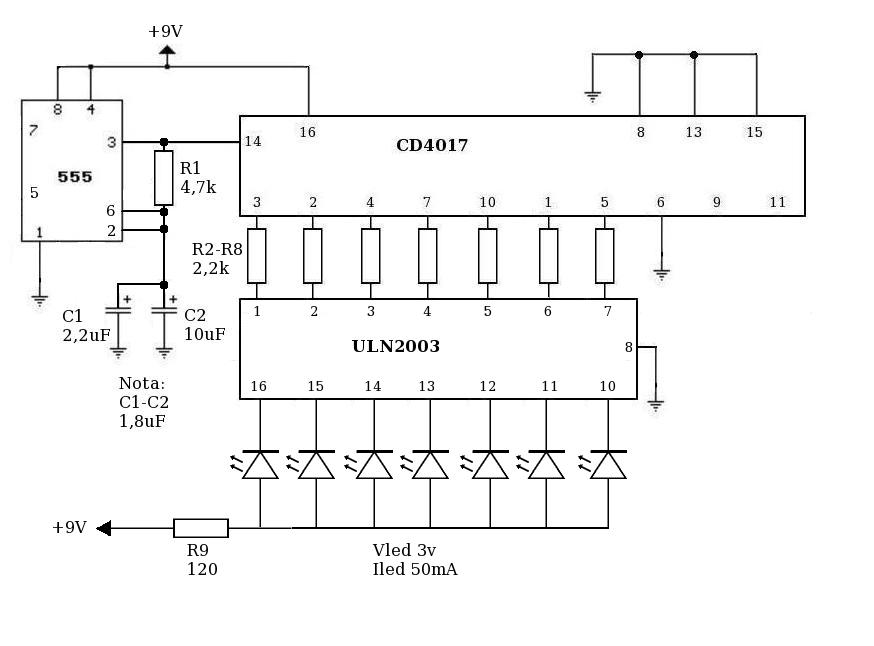

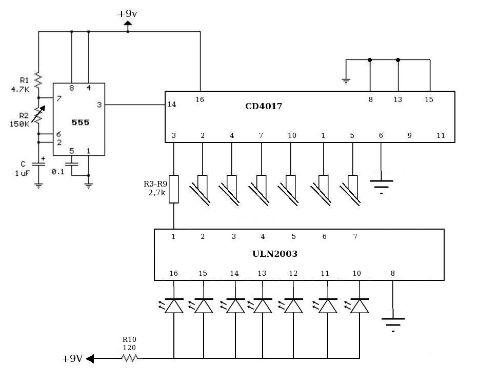

Another help to understand.
I've found some scheme using ULN2003 (like someone suggested me in this thread) that replace long number of BC547.
These are my questions:
1 - In some scheme connection between CD4017-output and ULM2003-input are directly
and in some others is used a res. It's the same thing?
2 - pin9? what I use for?
3 - The input signal from CD4017 is used only to activate base of transistor inside
ULM2003 so collector and emitter do the rest. Right?
Thank in advance. Alex
PS: My leds are always 3,4v - 50mA - High Bright
If you looked at the datasheet for the ULN2003 then it answers your questions.
Its built-in input resistors are designed for 5V logic but yours is 9V. You can add a series resistor to each input or use a ULN2004 that has higher value input resistors.
It is used so that its free-wheeling diodes arrest the high voltage spike created when an inductive load (relay, solenoid or motor) is turned off. Your LEDs are not inductances and you don't need pin 9 so don't connect it to anything.
3 - The input signal from CD4017 is used only to activate base of transistor inside ULM2003 so collector and emitter do the rest. Right?
Correct.

OK. Done. ULN2003 works very fine.
Unfortunately it has only 7 input/output. Better is ULN2803 or 2804 which as 8 input/output (but not 10!).
So, another simple scheme done and understand how to use it.
Thanks to all.
Alex
