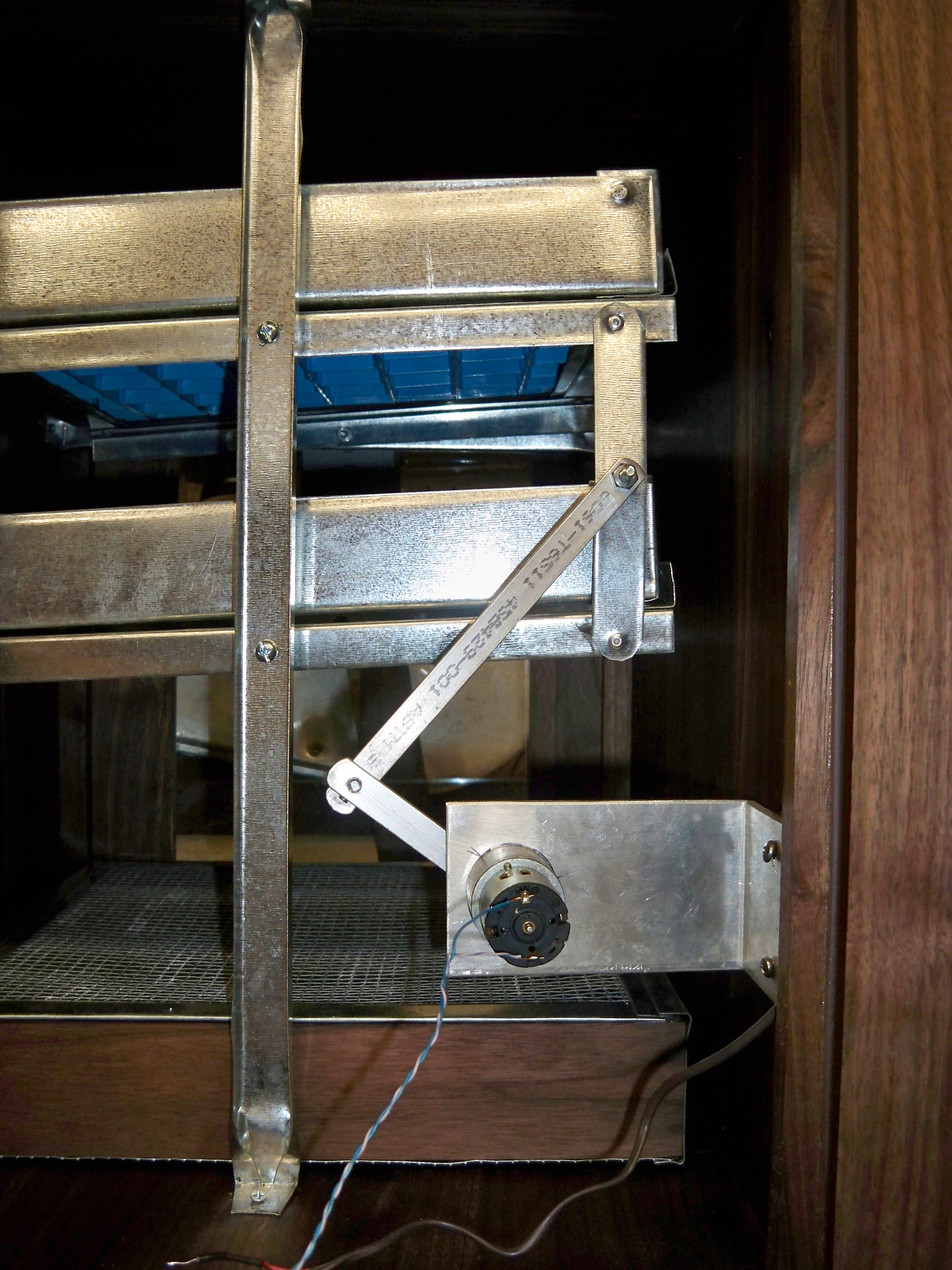

What i want to do is to build a circuit that will turn power on to a 4v motor for a variable time frame ( maybe a pot adjustment) then turn off for a adjustable time frame the same way. I have a solar tracker that does this.

Ok as it is, the motor at 12v rotates 1 time every 15 seconds @ 4v is rotates 1 round per 45 seconds.
As for the supply power 120v would save me the room on the pcb but 12v supply will suffice. I have more transformers to use, just limited space.
Ok, now I am totally confused. Do you care where the motor arm stops, or do just want to move a random amount each time you move it?
How far does the motor turn each time the 555 timer's output is ON?
It doesn't matter which position that it stops each time it just has to make 1 full revolution total 24 times a day. So it could move for 1 or 2 seconds then stop for max time. then repeat. the arm makes full rotations. i don't have limit switches on the arm.
rotating 24 times a day would be perfect but it can make more rotations if it has to. Just as little as possible.
