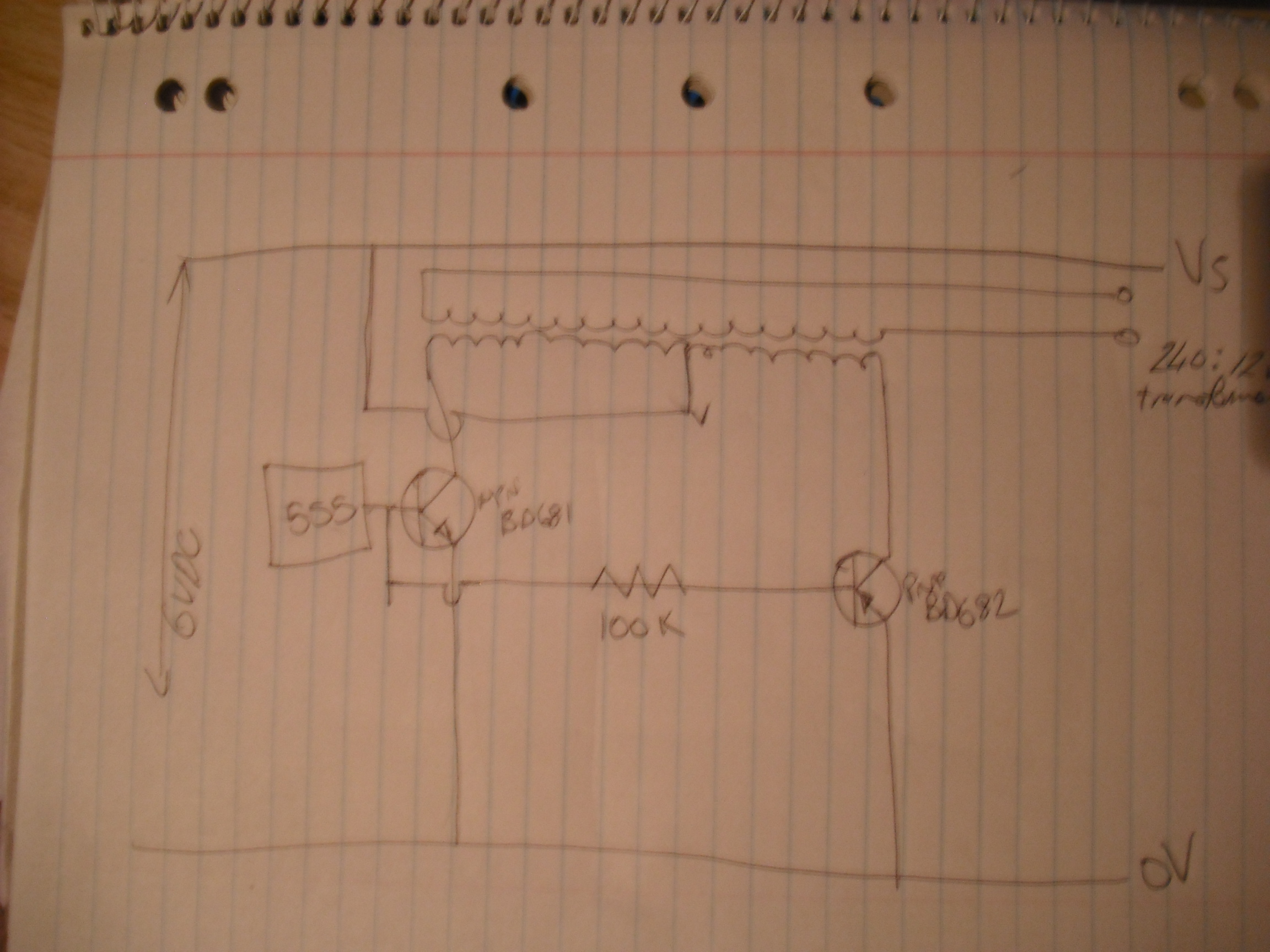

Gday. well i designed this peice of garbage and worked on it all day. just doesnt work.
basically if i put leds in place of the transformer they alternate, but put a tranny there and no go. just seems like not enough current, but as i understand it the 555 will output 6 volts and 200 ma, so shouldnt that be plenty to saturate the transistors?
the 100k is there to stop the bases turning eachother on.
would be very greatful for any help thanks.

The PNP transistor has its C & E swapped. The 100k resistor is way too big to sink enough base current from the PNP transistor. You might find it works better if you connect another 555 after the first 555 as an inverter & use its output to drive the second NPN transistor (replacing the PNP).
mmm thanks mate, o yeah sorry i drew the pnp wrong the c and e are swapped. theres no problem with having the load on the emitter side of the pnp is there?
i was just flicking through these forums and someone said as a rule of thumb in switching the base current should be 1/10 of the collector current, recon thats right? im starting to think the 555 is not very good for inverters as it only has one output.

You have another serious problem: the NPN transistor has no base resistor, so the output of the 555 is clamped by the base to emitter diode. As mentioned, the PNP is upside down, and the 100K is too high. Put a 1k resistor from the output pin of the 555 to the base of the NPN and the base of the PNP.
btw- this is not a very good design for a lot of other reasons, but doing the above should at least make it work long enough for the transistors to overheat and blow up
thanks mate, dont really understand what u mean by clamped but i suppose you mean doesnt work . and il try a 1k resistor on the output.
one thing tho, im thinking the tranistors would overheat from over current to the tranny windings. how would you limit this? to whatever say 3 amps for this particular npn
Just to be clear, you need two 1k resistors, one for each base, both of which are connected to pin 3 of the 555.
The base-emitter of the BD681 caused over-current in the output of the 555 and probably blew it up. It needs a resistor from the output of the 555 to the base of the BD681 to limit the current.
Replace the BD682 with another BD681 and drive it with a logic inverter which could be a second 555.
Then you will have a square-wave low power inverter without any voltage regulation.

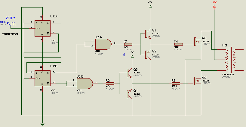

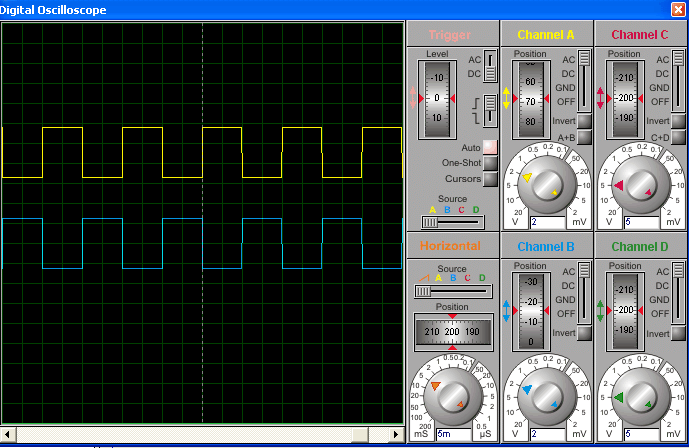

Here is a simple inverter circuit using MosFets to power the transformer.
Output frequency = input frequency/4.
The BUZ11 can make 33A at 25deg/C - much to play with.

actually, could anyone explain why there is both an npn and a pnp connected to the gate, looking at the mosfet, they are connected to the 0v . There will be a positive and negative pulse from the pnp/npn section wont there?...or perhaps mosfets triggger on both pos and neg pulses?
The gate-source of a Mosfet has a high capacitance that takes a fairly high current to charge and discharge quickly so that the Mosfet switches quickly. If the Mosfet does not switch quickly then it spends time ramping slowly and getting very hot.
The NPN transistor has enough current to quickly pull the gate high to turn on the Mosfet quickly. The PNP transistor has enough current to quickly pull the gate low to turn off the Mosfet quickly.
But since this inverter operates at such a low frequency then the transistors do not do much.
