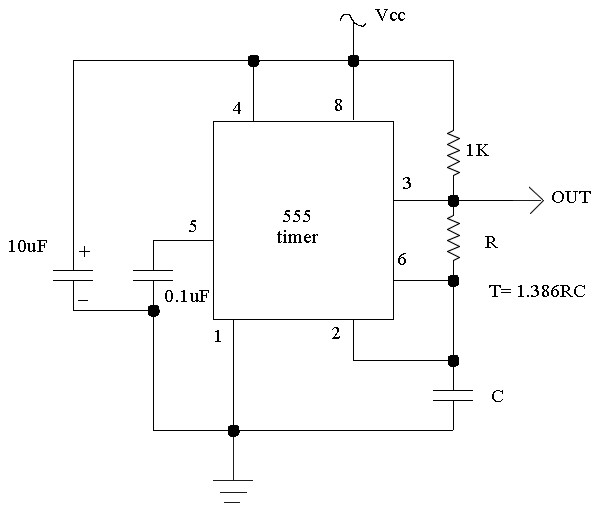

k7elp60 said:
Looking in my copy of "The 555 timer applications sourcebook" by Howard Berlin, he recommends the pull up resistor from pin 3 to Vcc and the value should be at least 1/10 the value of the resistor from pin 3 to pins 2 and 6.
What does this circuit look like from your book?
thanks,
Corey
thanks,
Corey
This is the circuit diagram
Roff said:
The equation is wrong. It should read
F=1/(1.386RC), or equivalently
F=0.721/RC
Roff is correct, thank you Roff for keeping my diagram and post accurate.
I have corrected the post this refers to.
