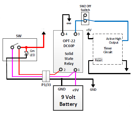

I think what alec_t was referring to was the issue I told him about me using an OpAmp as a buffer since the output of the timer goes to the SSR but the SSR was loading down the timer and I was having an impedance mismatch. block diagram of the circuit is shown below

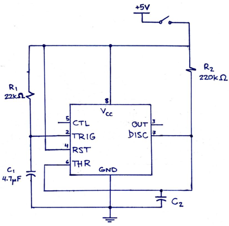

When the timer turns on, the timing capacitor starts charging. If it detects the signal it immediately discharges to 0 and then starts charging again. When it charges up to the threshold voltage the timer turns off BUT the timing capacitor discharges very slowly instead of immediately discharging to zero. This ends up effecting the actual time (i.e. 2 minutes) the timer is on for when the timer is turned back on after turning off. In other words, if the timer turns off and I turn it back on right away, the timing capacitor has not fully discharged yet; therefore, now that it is on again, instead of 2 minutes staying on its on for less (i.e. 1 min and 30 seconds). How can I make sure after the timer turns off, the timing cap discharges immediately similar to when it detects the signal which results in resetting the time?
Don't understand that.
The DIS pin should immediately discharge the capacitor to ground when the pulse naturally ends.
Do you have the DIS pin connected directly to the capacitor?
It would seem you don't.
What turns the timer power off?

The DISC is directly connected to the capacitor. Diagram shows how I have connected the circuit. It does seem rather odd to me too that it won't discharge immediately. When I look at the voltage across the capacitor with a multimeter I can see its a rather slow discharge not immediately to zero; whereas, when the transistor momentarily shorts the timing cap, the cap immediately discharges to zero.
I'd assume once the timing cap reaches 2/3Vcc the internal flip flop resets and turns on the internal transistor which allows timing cap to discharge. I do not have any other way of turning the timer power off.

If the DISC connection doesn't discharge the cap at the end of the pulse then you may have a faulty 555.
Has the DISC pin every been accidentally connected directly to the V+ (5V) voltage?

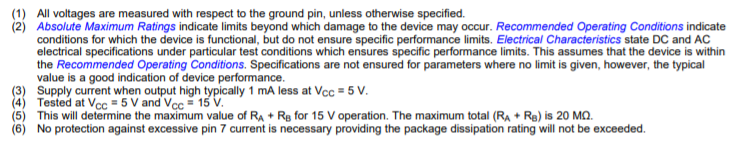

Item 6 seems to imply we can connect a V source to discharge pin and no damage will occur. I have my doubts.
The rated output V at 200 ma is 2.5 typical implying a sat R of ~ 12 ohms. Further internal bussing of power rails
limitations in this type of part I would look into as well as no mention of that in datasheet.
So in short putting a large V source (bulk cap) directly onto pin, eg. a large cap, I would have some concern.
maybe a small series R would add some prudent margin to the application.
Just a thought.
Regards, Dana.
Ground >> Cap >> Resistor >> Discharge Pin, all in series, so that R limits max current when discharge transistor
turns on to remove charge from cap.
Regards, Dana.
He means a small value resistor (e.g. 100Ω) in series with the timing capacitor
A similar precaution here (general CMOS parts) -
The 555 die looks something like this -
The large structure lower left is the discharge transistor. The spec says typ 2.5 volts @ .2A for the output.
Thats 1/2W and all that power is concentrated in that area of the die. Thats "typical" spec. Think dissipating 1/2W
in a 1/4 resistor, hot ! Compound that with a die attach that is not 100% (read move heat into leadframe)
area coverage and you have a recipe for silicon hotspot = melting. Note above die is CMOS version.
Then think of the ground buss, looks hefty, but takes a low power microscope to look at it. Dump all that current
into ground buss and you get noise margin compromised. Just some thoughts.
Regards, Dana.

So I figured one thing out regarding this problem however I am not sure if adding a small resistor in series with the timing cap is the solution or not.
When I set up the timer circuit on its own and turn it on with a +5V source, after timer turning off the timing cap discharges instantaneously. However, when I integrate the timer with the rest of the circuit, the device turns on with a +9V then the timer gets its power from a test point on the device which is a +5V and then the timer's output connects to a Solid State relay, that is when the timing cap does not discharge instantaneously. In other words, when the timer is on its own the timing cap discharges fast, when the timer is integrated with the whole system that is when the discharge slows down. I will try to put a small resistor in series with the timing cap to see if this could help or not. I also took your advice on the possibility of the faulty 555 and changed the chip but clearly that was not the issue since when the timer is set up on its own I do not face any issues as far as discharge is concerned.
How are the 9V and the 5V connected to the 555?
for the sake of testing I am using a DC Power Supply but in the practical world it would be a 9V battery supplying power to the device
