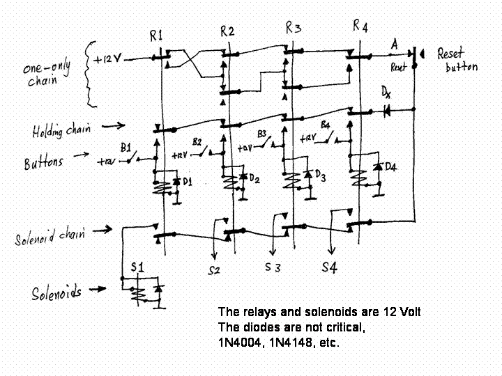

I want to control 6 LED's with 6 spst momentary switches. When no switches are pushed, no LED's are lit. When switch 1 is pushed, LED 1 lights and remains lit after switch 1 is released. If switch 2 is then pushed (and released), LED 1 turns off and LED 2 turns on and stays on. (etc for all switches)

Understood, I'll post a circuit for you later today.
You did not say how many solenoids there are, But the circuit is easily expanded to how ever many you want.

This is my suggestion.
I've only drawn 4 relays as I don't know how many solenoids you have. But it is easily expanded to however many you need.
The first and last relays are wired as per R1 & R4, the intermediate relays are wired as per R2 & R3.
Circuit description:-
When the power is turned on, all relays and solenoids are in the released state.
If you examine the "one-only" chain, you will see that there is a path through it if one and only one relay is operated.
If say Button B3 is pressed, R3 operates and holds via the one only chain, the reset button, Dx and the holding chain.
S3 is operated via the "one-only" chain, the reset button and the solenoid chain.
If say B1 is pressed, R1 operates and thus 2 relays are operated at this point. So the "one-only" chain goes open and therefore R3 & S3 release.
When R3 releases, the "one-only" chain is closed and so R1 holds and S1 operates.
When you want to release the operated relay and solenoid, press the reset button or simply turn the power off.
The diodes across the coils protect the contacts from the back EMF when the coil circuit is opened.

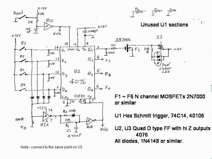

What he means by brteak before make is:- do you want the operated solenoid to relaese before the next one? In other words, will it matter if 2 are both operated together briefly?
If you want to make the relay version "break before make", you will need another relay. Let me know if you want to do this and I'll modify the circuit.
I'll post an electronic suggestion for you shortly.
Here is another suggestion.
It has a delay to ensure that the operated solenoid is released before the other one operates.
Is your +12 Volt supply clean? ie. could there be spikes in it? If so, the ICs will need protection against them.
Circuit description.
When the power is turned on, U1c applies a high to the reset inputs of U2 & U3 which sets their outputs low, so no solenoids operate.
If say B3 is pressed, the output of U1b goes high after about 50 ms. This enters the data on the D inputs but since the outputs are disabled no solenoid operates.
About 0.5 second after B3 is released, the output of U1b goes low and thus enables the outputs. So Q3 goes high F3 is turned on and Solenoid 3 operates.
If say B1 is pressed, S3 is released after the 50 ms delay but S1 will not operate until the 0.5 s delay expires.
The operated solenoid can be released by pressing the reset button.
I have suggested using dual colour LEDs across the solenoid coils to provide protection of the Green LED against the back EMF from the coil when it is released. The Green LED is protected by the Red LED. If you used a normal LED, it would need a diode in parallel to protect it.
You will notice a short flash of the red LED when the solenoid is released. What is the resistance of the solenoid coil?
Note that the LEDs and resistors also protect the MOSFETs from the back EMF.
