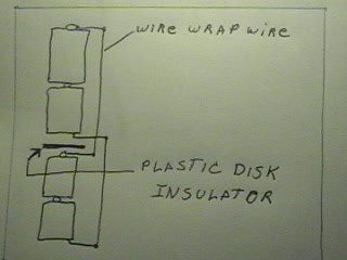

ok you have four batteries available..
problem is they are in series giving twice the reguired voltage..
why not rewire them giving two 3v in parallel with the other two.
solution : a little creative wiring..
see picture..
