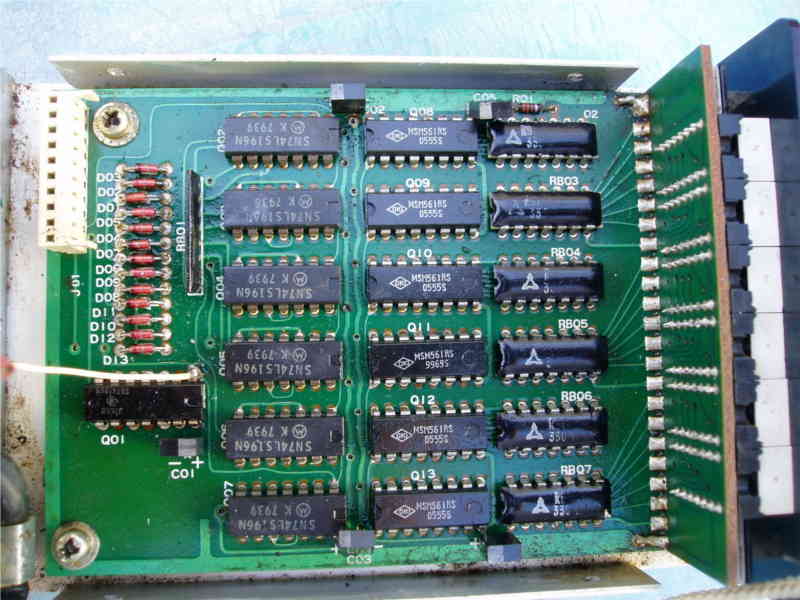

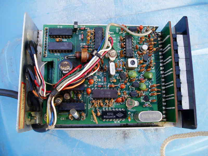

Here are pics-The wire is midway up on left side white red heat shrink on end -hard to see on first pic --is from bottom board- see next pic but may or may not come up the back , probably attaches back on to the same bottom board somewhere but I can't detect any plausible solder residues on pins as yet . Thats why I tried it up the back to the top board somewher
Oh Freq counter is a Yaesu YC-7B and I think I have a circuit but hav'nt found that yet either.

OK. In the second pic, the column on the left are the cascaded 74196 chips, five of them and five 7-segment LED displays. That makes the middle column the decoder/drivers for the display and the right column are resistor packs for current limiting of the display LEDs. I can't make out the decoder/driver type numbers -- I don't see 7447 or anything like that on them. Having five D/D chips tells me that the display is not multiplexed.
Thats seen a few years, the front end board looks complicated.
The white wire in your picture is connected to pin1 of Q01 and it should be connected to pin10 of Q15 on the other board (74LS04). I suspect that this wire was added to bypass a defective connection in the plug and socket that connects the two boards or a broken pcb trace. To cross check, you could clean the tip of your soldering iron and check for pieces of the wire in the solder.

Careful examination of that pin shows no additional soldering that I can find on the top of the pin . On the bottom is a possibility so I will check that carefully for wire in the solder as you suggest. I have one other problem with it too . I have lost the display for thousands altogether and am investigating this so I wondered if this could go to the 5th bank of counters.
I would not worry about the lost digits yet until after the "load" wire is connected. It was probably soldered under the board.

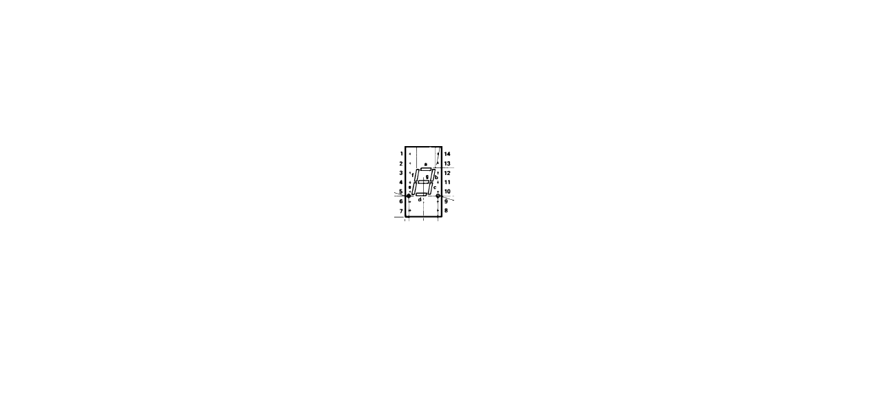

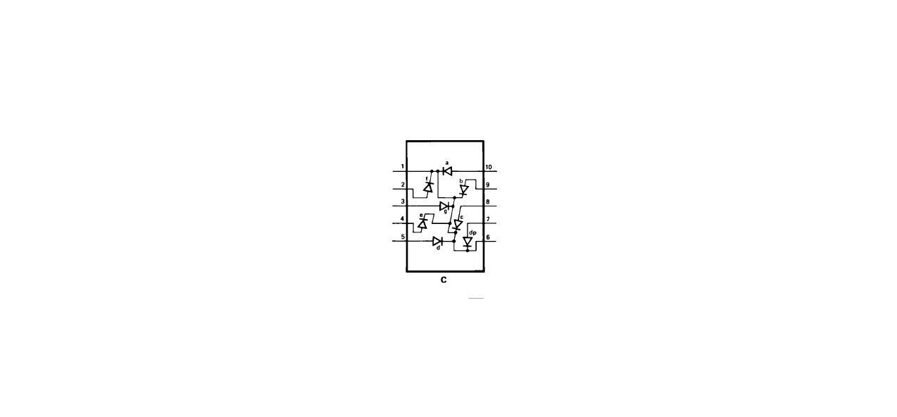

I had power problems. Let's start with the display, part number 5082-7740. It is a common cathode display and I have attached the internal connections taken from the datasheet
I'm assuming that the defective display is the second one from the bottom of your pictures, D505 and the other digits are working.
With power removed, check that pin 1 of the display has continuity to ground. Here are the pin connections viewed from the front
The display circuit board is soldered directly to the main counter board. It is possible that there is a break where the solder connects to the display board ( the connections for this display are under the circuit board from the resistor array R806 ). Check for continuity between the display pins and the resistor array R806. The value of the resistors in R806 are not indicated but should be about 330 ohms.
