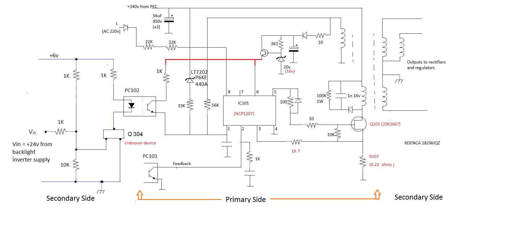

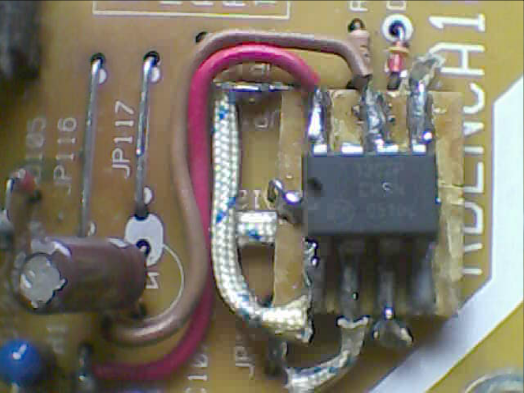

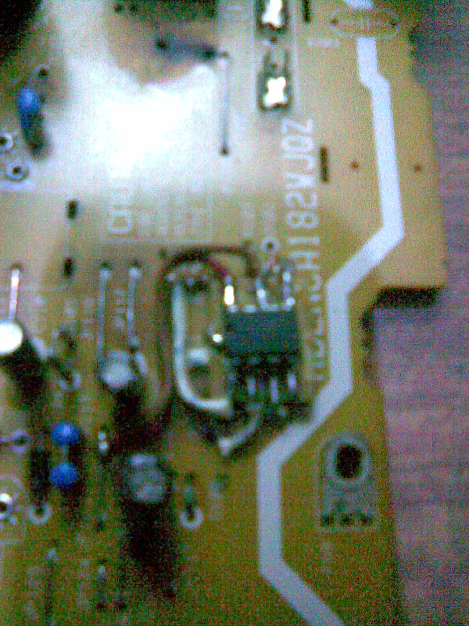

Thanks for your offer of help with spares. I have attached a picture of the modification I did to get the tv in question working. Surface mounted components are not available here so I made a small circuit board, mounted a through hole NCP1207 on it and wired it on top of the power supply board.

I could not make out much detail on the pic , perhaps a pretty charred area and some heavy solder tracks, maybe some wires from the 8 pin chip
Hi april, that is an ideal range of soldering irons. It would be nice to mount the ic properly. You could practice on an old circuit board. The quickchip flux will help the solder to flow better. I usually apply some fresh solder to a joint before using the sucker.

Sorry about the poor quality of the picture taken with my ancient phone. I have attached a closeup and part of the schematic that I had to draw because I could not find it anywhere on the internet.

Oh thats much better , a very complex repair.

No, it's not complex, just needs some concentration for about 30 minutes. Evidently they are CMOS devices so the usual anti-static precautions will be needed.
