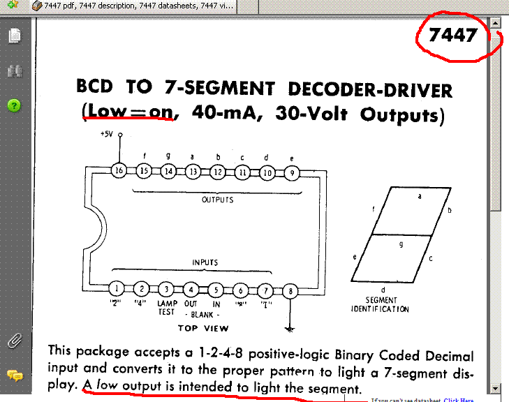

TI lies! Here is my datasheet, showing all segments high except for "g", which is low displaying a "zero"

Yours shows the state of each segment... on or off.
The other sheet gives the condition that results in the segments state.
Confusin', ain't it.
State or condition doesn't mean a difference. Knowing that the LS47 is an open collector driver makes sense to me. Open collector logic is on = low (negative logic)

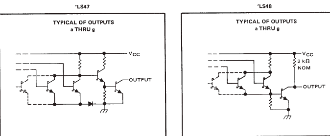

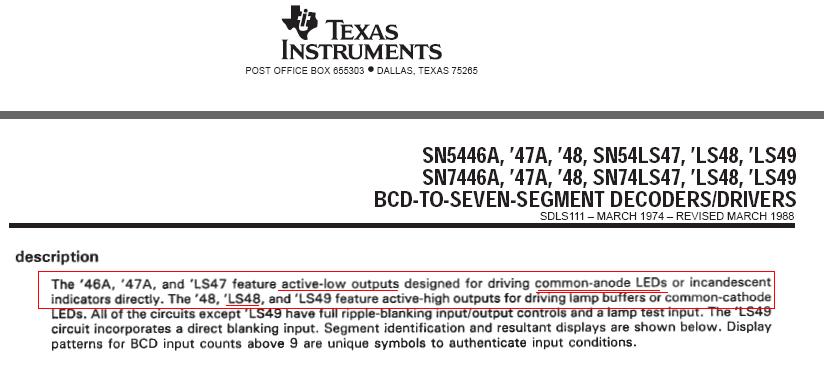

A small correction here: It's the LS248 decoding numbers displaying tails.
LS48 ist just the equivalent for the LS47, this time with positive logic, on = high.

This should clarify. Here are the outputs for the 47 and 48. :)

And, here's more from the data sheet:
