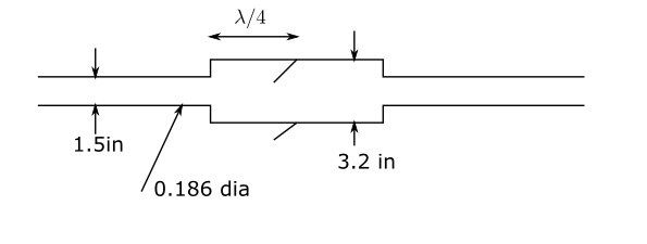

Assuming that the feed impedance of one bay is 300 ohms, then you would run 300 ohm line to where they join, and when you join them in phase, the impedance would be 150 ohm as you say. If you want 300 ohms at the junction (to use your standard balun), then what you could do is make the last quarter wavelength to be sqrt(300 x 600) = 424 ohms to transform the impedance to 600 ohms prior to joining. The 600 ohm from each side would then parallel up to make 300 ohms seen by the balun. You could do this by keeping the 1.5 in spacing and reducing the wire diameter to 0.09in (using: https://hamwaves.com/zc.circular/en/index.html,) or keep your wire diameter of 0.186 and increase the spacing to about 3.2in, like:
lambda/4 at 550MHz is around 5.4in.
If the assumption of a bowtie impedance of 300 ohms is correct then this will improve the signal combining, if the assumption is incorrect then it may not. Experiment! Also you don't need hard right angles as in the diagram - you can 'smear' out the transition a bit. 3.2 in is also getting a bit wide for a tx line at these frequencies, you could also try the thinner line option.
I think you answered my question. Wire diameter and spacing makes 600 ohms on both sides. When the 2 sides are connected in parallel the connecting wires are 300 ohms so those connecting wires need to be sized and spaced to make 300 ohms. Now 300 ohm to 75 ohm balun can be connected to 75 ohm coax 60 mph hour wind is common in every storm..
Bow ties are 1.5" apart. Transmission line calculator says I need .023" diameter wire to = 600 ohms. I probably should have calculated transmission line spacing first then made bow ties fit the transmission lines. The very first thunder storm & high wind will break .023 wire. We live in tornado alley.
If I use 1/4" copper tubing for wire I can get 150 ohm transmission lines on both sides. I can use .250" copper tubing to parallel the 2 sides to get 75 ohms for the coax. No balun needed.
300 ohm transmission lines paralleled = 150 ohms this won't work unless there is a trick I don't know.
What I really needed to know was that ohms of connecting wires are 1/2 the ohms of both sides. I could not find that online or in books. Someone already mentioned it I just wanted to double check.

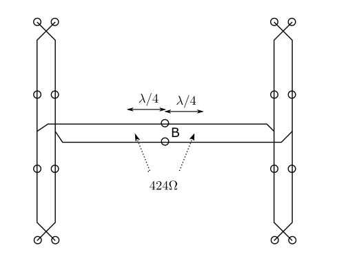

If the assumption of 300 ohms for the bowties is correct, then this is how you combine them:
All the transmission lines are 300 ohms (D/d about 6), except for the quarter wavelength either side of the balun connection at 'B'. If you make this line 424 ohm (D/d about 17), then that will transform the 300 ohms from each bay up to 600 ohms, so that when you parallel them at 'B' you get back to 300 ohms. In case you aren't familiar with the quarter wave transformer: https://en.wikipedia.org/wiki/Quarter-wave_impedance_transformer

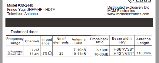

I really have not paid attention to typical gain figures for TV antennas, but the spec'd gains here do sound a bit low for an antenna that advertised for a 60 mile range. And the beamwidths seem a bit wide. But then again, maybe these are typical, I don't know. The F/B ratios are quite good though.

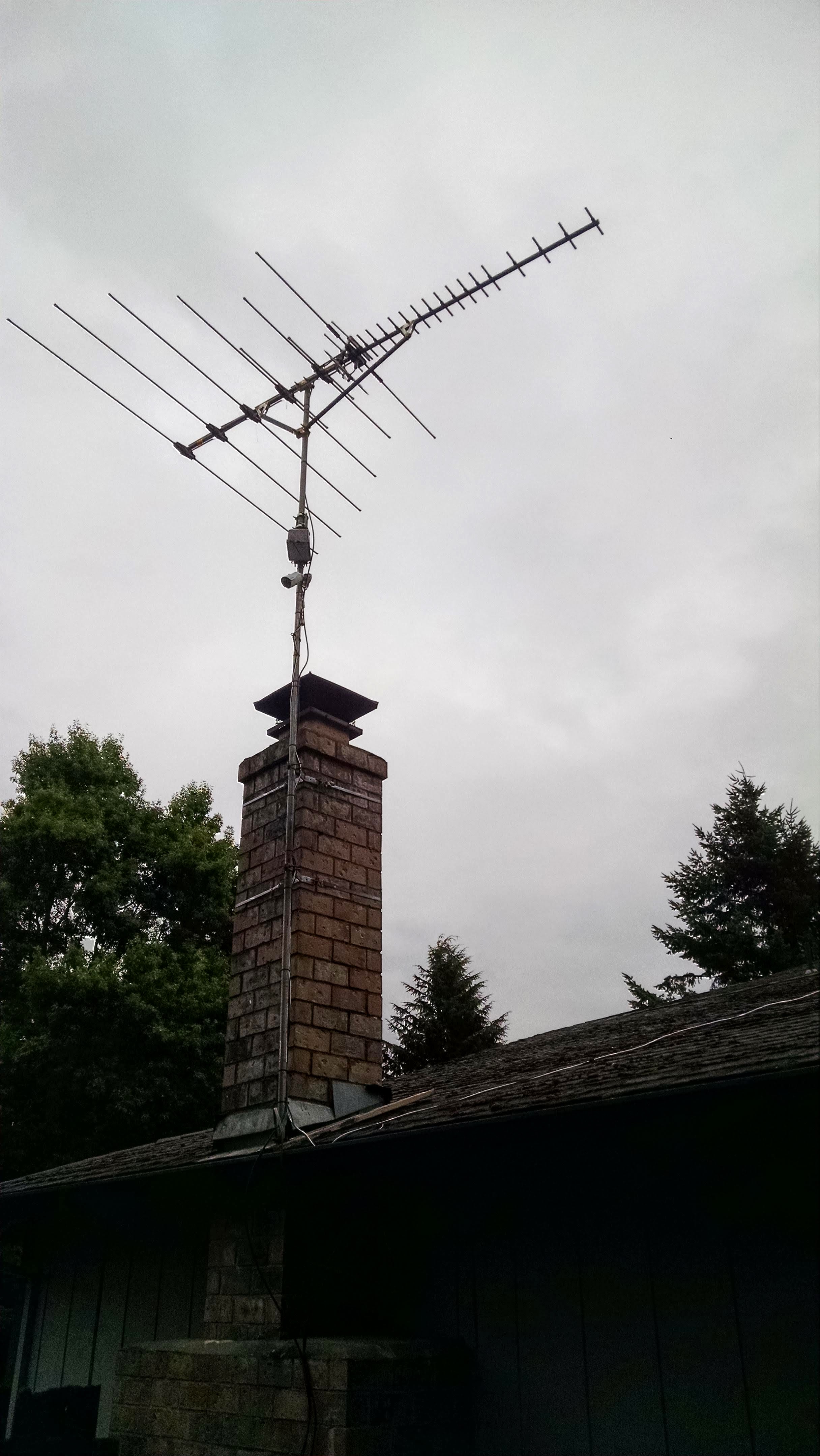

My OTA setup.
