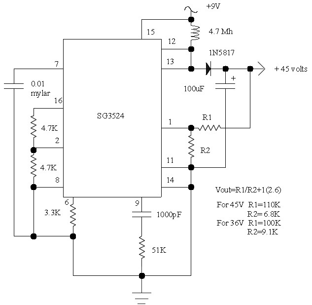

1)I would like to take a single 9 volt battery and be able to power a device that needs about 31 or 32 volts to function properly.
2) I would like to be able to keep it at the same current as the battery weakens ( obviously within reason )

You didnt specify how much output current you need at 32v, or if it is ok for the 2 ground wires to be connected?
Try a google search for "simple SMPS boost regulator" which will give you a head start.
Also have a look at the cheap little 8pin IC; google for "34063 datasheet". That is a nice little chip for lowish power boost or buck supplies.
Here is a circuit I designed and built several years ago. You will have to adjust the values of R1 and R2. As far as I remember because of the feedback system in the 3524 the output remains constant with the 9V battery discharging.

I don't know what the chip does enough to figure out what R1 and R2 do. Can you help me by letting me know what those two values need to be inorder to output 31 volts.
Do the numbers on your schematic represent the actuall pin placement eventhough they appear to be out of order on the schematic? Do I just connect the pins not being used to the ground?

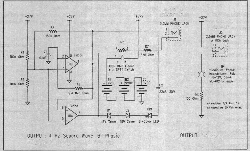

The schematic I have calls for 3, 9 volt batteries. I want to power it using 1. The original plan called for 27 volts ( hence 3, 9 volt batteries) but the original plan was altered to 31 volts for optimum effect. 3, 9 volt batteries makes the unit somewhat big. I want to make it portable ( handheld ). If I can use 1, 9 volt battery and give it continuous 31 volts I will be able to make it portable as well as effective longer, with the continuous voltage.
The schematic up above given to me by k7elp60 would work well if I can get the output at 31 volts. I can then add that schematic to the input desighn that I have and everything should work just fine.
.....that and a quick understanding of the pin #ing and what to do with the pins not used and I should be able to play dot to dot and put it together. I apologize for my lack of pretty much everything electroincs. I'm asking for help with no merit and no contribution whatsoever. Hence my gratitude for everything considered.
I am not sure what you want my schematic for..but here it is: Do you think you might be able to help me with the schematic I have been asking about?
This is the other schematic in question. I need those 2 resistors R1 and R2 changed so the output is 31 volts. And a quick response to the pins as mentioned up above in earlier posts.

I recalculated and the values for R1 and R2 shown for 36 volts are actually for 31 volts. The output may vary from this as the reference voltage out will have an effect on the output voltage. So you may have to adjust the values of R1 and or R2 to get the right voltage. The reference output voltage on pin 16 is divided in two by the resistor divider between pin 16 and ground with the midpoint connected to pin 2. This reference voltage can vary from 4.6 to 5.4 volts depending upon the IC.
The pins shown are actual pin#'s. You should not connect unconnected pins to ground.
So if I understand you correctly. The constistancy will be there but not perfectly at 31 volts. And it will stay within that consistancy as the battery dissipates ( within reason ) +- a volt or two?

Yes, it's a boost converter you want. They can be programmed with a couple of 1% resistors. The problem is they are not 100% efficient.
