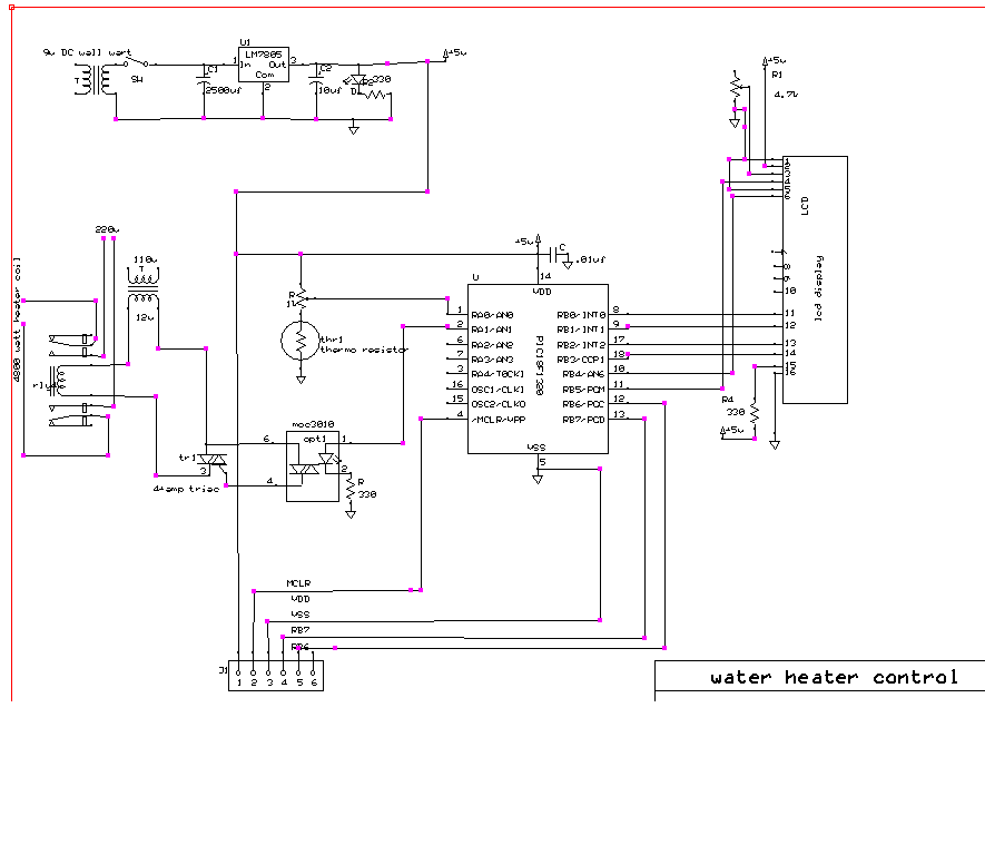

here is my schematic for the water heater control

The MOC3010 normally expects 120VAC. With only 12VAC it doesn't reach a good trigger voltage until fairly late in the cycle.
Any reason your contactor coil is on an isolated 12V circuit? Could it just as easily be 120V?
Can get (need to recheck with Mouser) but an 120ac coil is available as is a 12v DC coil.
If I go with the DC coil then instead of the triac just use a opticoupler with a photo transistor inside. Of coarse add the diode across the relay coil.
yes available in 120ac coil BUT can't locate a socket so I can install on a pcboard.

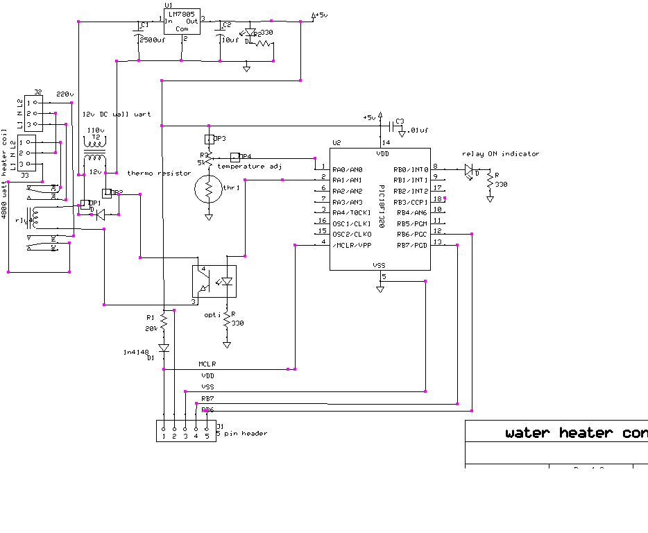

revised schematic
Need a heat sink for regulator or ??
Looked at replacing the thermostats but then the water can get up to 90 degrees if I order online.
this relay will only turn the heater on when the water temp is lower that a set temp (60-70 degrees). then only when needed.
Looking at schematic (12vdc coil on relay ) but the PIC uses a 5v regulator. Must be a better way to chop the voltage so heat is not a factor (big jump from 12 v down to 5 volts).
ac coil not in stock from Mouser or Digi key?
