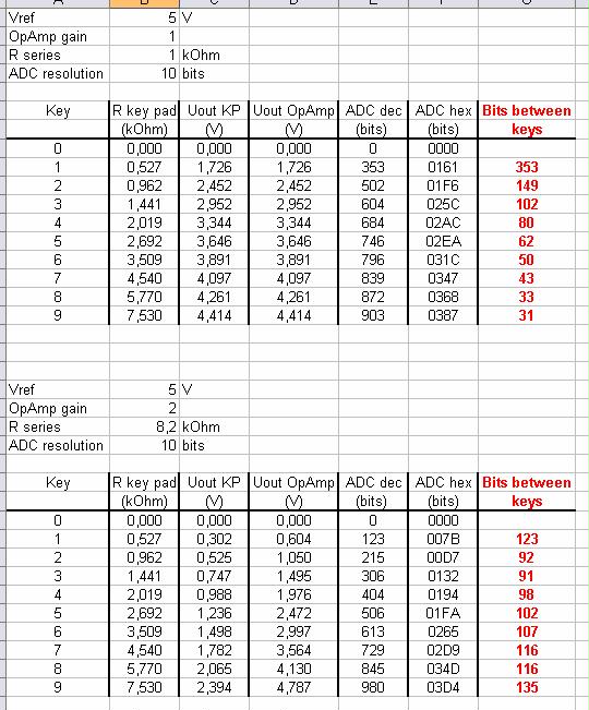

Find the expected ADC value for each key in the attached file.
Interesting is the fact that between keys 8 and 9 you have a variation of only 31 bits !!
With the 8k2 and opamp gain 2 setup the minimum difference between two keys is 91 bits !!
Less chance of error while decoding the keys :)
Your choice of course... ...

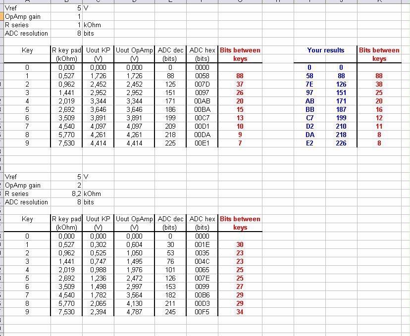

Your measured data match my calculations :D:D at least when I take the left aligned PIC stuff into account.
Since you don't use the 2 lower bits it's just like if you have only an 8 bit ADC instead of a 10 bit.
Columns E / J (dec) and F / I (hex) are equal.
Keep up the good work.

It's not the absolute value that matters, it's the minimum difference between two different keys.
With the 1k setup it's only 8 bits.
What are the specs of the PIC ADC, ADC value +/- 1bit or something like that? That brings the range even lower to only 6 bits!

You have to think of noise, something no one can quantify.
You can of course take several ADC readings and average them.
By ignoring the least 2 bits you can only measure multiples of 4 bits.
4 bits on a 1024 bits range equals 0.0196V or
1 bit on a 255 bits range also equals 0.0196V
Noise of 19 mV will produce a +/-1 bit error in your readings.
Change your code in such way that you have automatic readings lets say every sec, write them down and see which variation you get.
Then move your circuit closer to any noise source and check ADC values again... ...
8 bit vs full 10 bit
I would use the full 10 bit range of the ADC, you have them for free, so why not using them? Code will be a little be larger but who cares (at least I don't need to write it :D)?
I'm absoluletly sure that the chance of an error in decoding will be much less with OpAmp and full 10 bit range, but I can't quantify it :( :eek:
