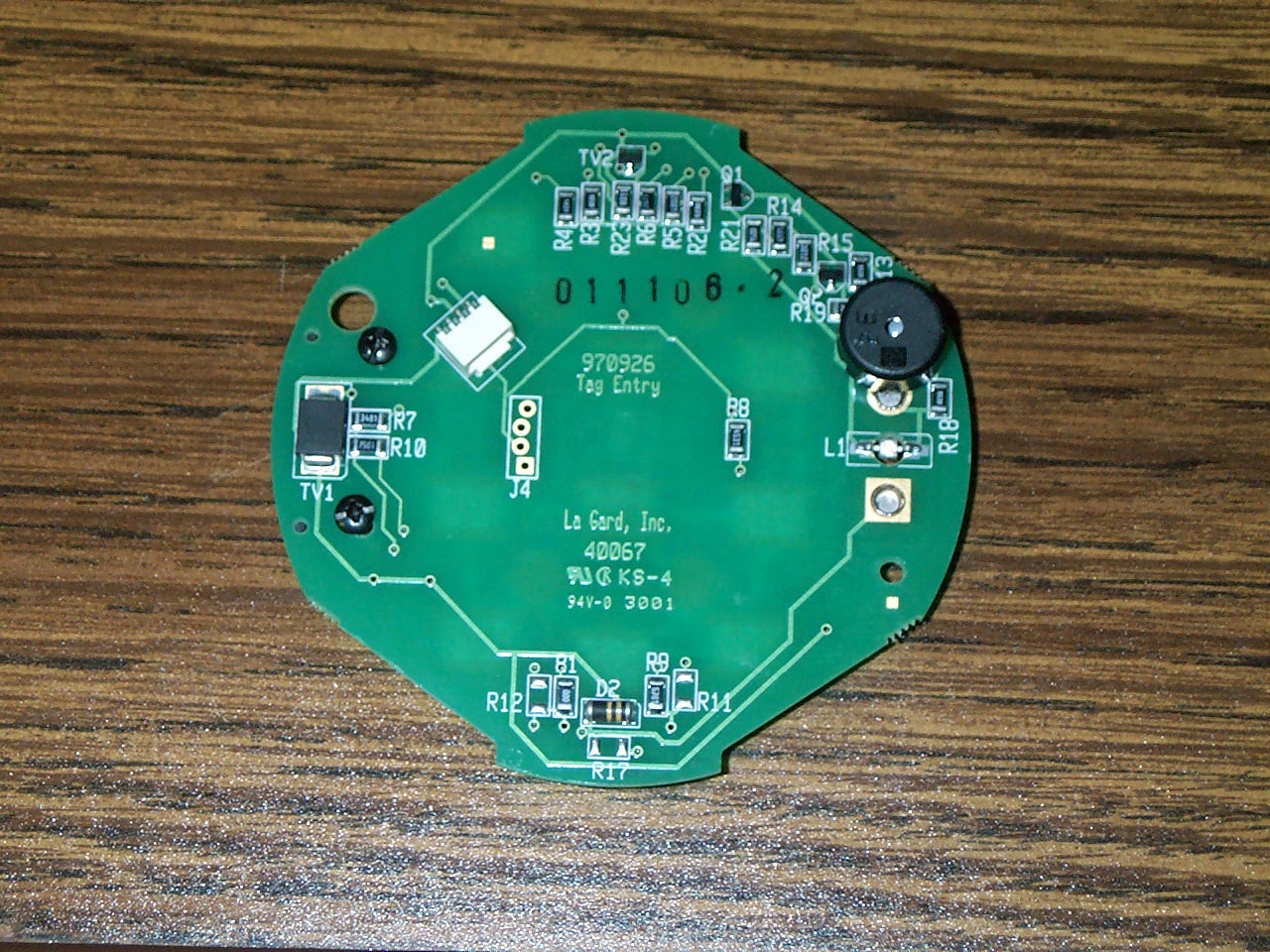

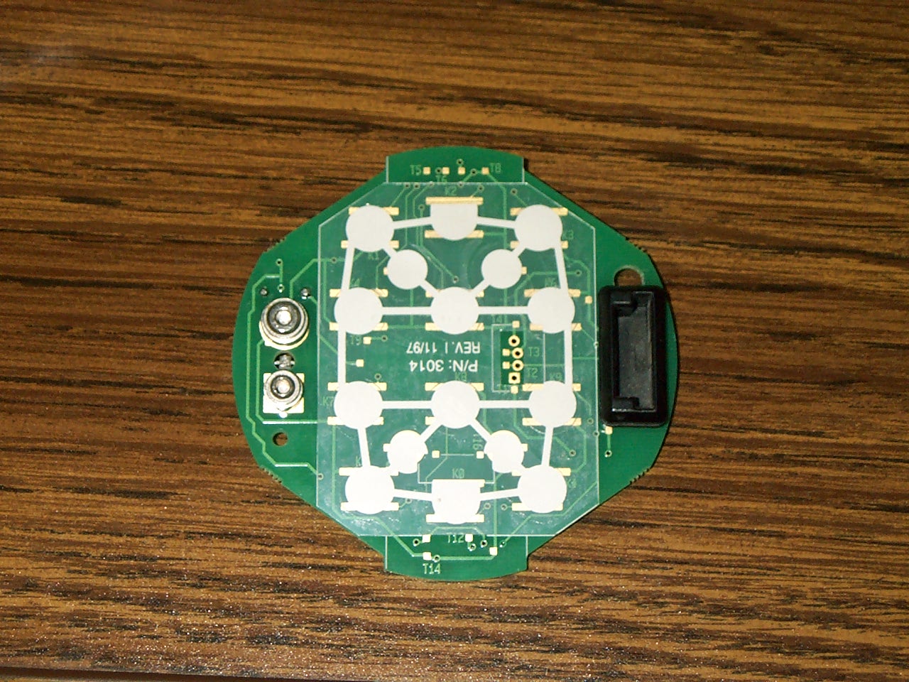

Just a couple of images of the keypad board, and my breadboard. :)
The images of the keypad board (DCP_5411 and DCP_5412) are of this keypad -- a Lagard LGAudit 3125 Round Entry Keypad. I choose this one simply because it shows the iButton port as well. The keypad attached to my breadboard is the one I linked to earlier (3000 Round Entry). The differences are;
Mine has no iButton port, but it has two batteries under the keypad.
The LGAudit keypad (board pictured here) has the iButton port, but no batteries on the exterior at all (you must utilize the second connector on the lock board for an external source) -- however, there are two terminals (see in DCP_5411, left side of the board) that will allow you to connect an emergency 9VDC battery, in case of internal battery failure.
TV1 and TV2 are only on the board when the iButton port is present.
R11 and R12 are not on any boards that I have seen -- they are for the "*" and "#" keys, respectively.
I haven't really studied R17, but I believe it to be a resistor that can be added to the ground pads of each button, providing resistance for a "no press" situation, as I currently have a "no connection" status for the "no press" situation. The keypad has been setup for multiple uses and is used throughout their product line.
I have not attached any pics of the lock board (LaGards), simply because it is a safe lock and I don't feel comfortable in doing so, due to security concerns. If you want to discuss it with me, I have no problems in emailing select individuals images of it (you can pick a schematic from them, for sure), I just don't want to post it in an open forum. Contact me vial PM if you wish. ;)

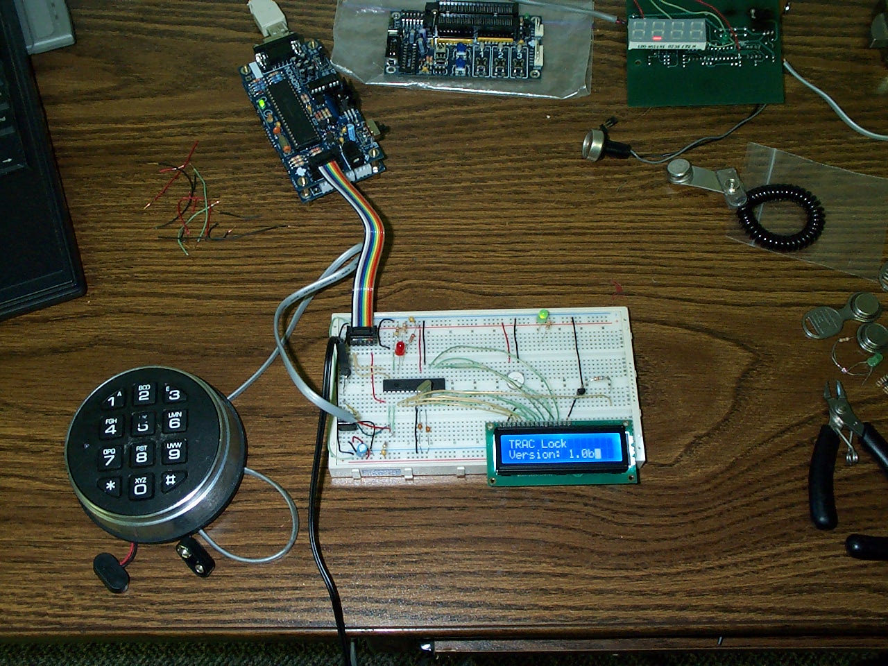

Oh, my breadboard -- DCP_5404 -- the grey cable comes from the keypad, the black cable comes from a 9VDC regulated Wall-Wart (actually made by LaGard for their locks). It is attached to an Inchworm+ (ICD2 clone) Debugger/ICSP with the Unicorn USB upgrade (the FireFly dev board can be seen beside them) and another of my lock board projects (iButton) in the top right corner. This particular circuit, when complete, will really only be the left side of the breadboard -- the LCD is just for development/debugging (and I may even drop 16F873 for a 16F88 as I don't need the I/O on this project). The red LED simulates a connection to the lock... it will have a connector there eventually. If you look at the board in the top right of the picture, the grey cable on it goes to the lock body (and you can just see the half moon shape of the lockbolt very top, right).
(I explain everything now as someone will ask -- hey, what's that in the picture? :) )

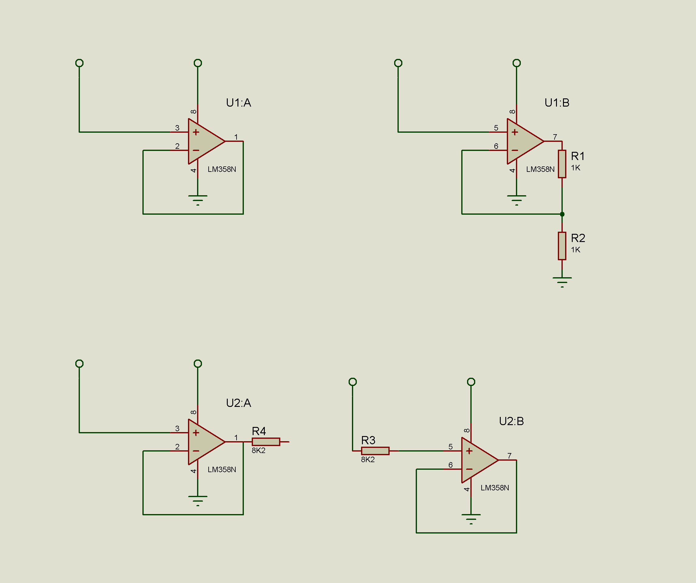

Hi All;
Well, I've finally been able to get out and pick up some parts... and now I need a little help! :)
I'm completely lost with the wiring of the op-amp. Well, I thought I understood it, but even the most rudimentary circuits don't want to work for me.
I didn't know what a voltage follower was, so I Googled it -- no problem, looks pretty straight forward (I told you I'm not a hardware guy!).
Today, I bought an LM358, single supply, low-voltage, dual op-amp and have been trying to wire it up since I got home. Right now I'm down to Vcc and GND wired to the LM358. That configuration produces 3.80VDC at both 1out and 2out (pins 1 and 7 respectively). If I add 4.98VDC to 2in+ (pin 5) and then return 2out (pin 7) to 2in- (6), should this not be a voltage follower and produce the input voltage at 2out (4.98VDC)? I still get 3.80VDC. It doesn't seem to matter how I wire it, I still get 3.80VDC. I've tried with an 8K2 wired to 2in+, I've tried a 1K between 2out and 2in- with another 1K between 2in- and GND and get 3.80VDC (I believe this is an non-inverted amplifier). (I'll have to draw up some schematics to make it easier to understand -- but these are all various methods of wiring an op-amp that I have found on the web).
(You're going to ask me why 1K above? The formula I found for gain was gain = RA/RB + 1, so 1K/1K = 1 + 1 = 2 was what I was thinking. Following that theory, I could have used any two values, as long as they were the same to divide against themselves.)
Anyway, I figure I'd get it to work as a voltage follower and then worry about gain... I am lost when it comes to "set a gain of 2". From what I understand, a voltage follower has unity gain (a gain of 1)... so how do I set it to 2? If I do set it to 2, wouldn't that be a non-inverted amplifier and not a voltage follower?
I have not been able to find a definition for "lock resistor" either (term used by mcs51mc a few pages back).
Thanks again!
Here are a few of the various ways I've tried to wire up the LM358.
Although you correctly chose a single supply op amp, it must also be capable of swinging to the positive rail. The LM358 can swing to ground, but not to Vdd. Google for "Rail-to-rail operational amplifiers".
A voltage follower has unity gain: outout voltage = input voltage (U1:A in your schematic). It just changes high impedance inputs to low impedance.
mcs51mc suggested a gain of 2 because, according to his calculations, you get better values. A gain of 2 is achieved with the 'non-inverting' configuration (U1:B).
Yes, the resistors must be equal. The value shouldn't be very low or very high and the choice depends on other parameters too. In the 10 k range for an LM358, in the 100 k range for a C-MOS op amp.

Lawrence is at the store and has a few rail to rail op amps to choose from. I told him I bought the LM358 there yesterday and he immediately said "nope, wrong one -- not rail to rail" -- (man, it's nice to talk to someone who knows their stuff) -- I am on my way to chat with him -- just wish he was there yesterday! :)
I have to put in a plug here for Lawrence at Creatron -- it is such a treat to be able to talk to someone who knows their stuff. (Creatron -- 255 College St., Toronto, ON M5T 1R5 416-977-9258)
Not only was I able to find the correct op-amp, I received a 10 minute course on how they work and why, what the difference between "rail to rail" and standard is and why I need "rail to rail". I had no idea what you guys were talking about as far as the "swing", but now understand that as well.
Oh, yeah, I ended up with an LMC6462, Micropower, 3/5V, single supply, rail-to-rail, dual CMOS.
At the same time, I took advantage of my trip and asked about the 3V power supply I needed, as well as a low quiescent fixed 5VDC regulator (as pointed out earlier for battery operation). I ended up with an LD1086 3.3V regulator to run a small stepper motor project and an LT1521CS fixed 5VDC regulator. The LT1521CS is SMD though -- it will be great for the finished product, but won't work for the breadboard (unless I feel like making an adapter) -- besides, the breadboard is on a Wall-Wart now, so no biggie. :)

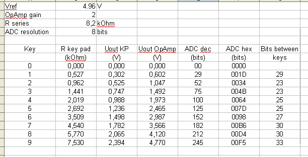

Well, just a small update for y'all...
The op-amp is working out awesome! Thanks eng1 for mentioning it... and to mcs51mc for the awesome calculations! I didn't realize we had Reputation here, so I've gone back and spread some around! ;)
Here are some real world numbers that I am getting now (bang on, mcs51mc!) -- everything matches up, except for the ADC, simply because I haven't gone to 10bit ADC yet... I'm still reporting what I'm seeing with 8bit ADC -- but I'm happy with what I see! :)
Thanks again -- I'll keep you updated. :D

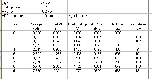

Now we're seeing some good numbers!
Here's some more real world numbers with 10bit ADC that has been right justified. :)
