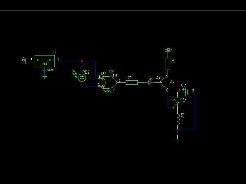

And what should i know before useing a XOR gate in a circuit. Yesterday i read a topic where someone bought logic gates and there was some complications with the high and low states. I just bought a logic gate for one of my projects, i will be haveing a 74f86 exclusive-OR logic. I wan't to have that logic chip to drive a transistor. So i would like to know how to connect the inputs. one input is should be always high, and the second input should be driven by a phototransistor. if the phototransistors signal has been cut, then the input should go Low so the output will be high. I have attached the datasheet of the 74f86 to the post. And if someone would give me a little schematic for it i would be very grateful. Cause i don't have any ideas myself right now.

I came up with a schematic but i don't know if it may work like this. The D? diode should be a thyristor but i didn't have a thyristor in the component list. so i modified it a little. I hope you can correct me if there is something wrong with my schematic. Oh and there are no values because i just don't know what should the values be and what transistor to use. Any ideas are welcome.
Oh and that capacitor will be loaded by another thing, but i didn't draw it on here. Cause i don't have the schematic for that. I know i could of made a little block with Cap Charger written inside.

im not the best when it comes to these types of schematics, but i think your diode is the wrong way around, and the transistor you have drawn is a NPN with your collector connected to +V ?
and you may be able to use a single input inverter instead of the IC you are using,because one of you inputs is always connected to +V
with an inverter the output is high(1) with the input been low, and the output is low (0) when the input is high (1)
And as for your resistor values, well the one for your base can be anything low i suppose, try 10K, 100K ?
And for the collector, it just has to suit your emitter load i think, so in your case a LED.

The diode on the ic output to the transistor base is a LED and it is the right way round.
A NPN transistor does have its collector to a +V supply.
He dosn't need any invertor or 7486 if he reconfigures the photodiode circuit.
This is correct.
Remember the forward voltage drop across the LED, say 1.8V and the Vbe drop in the transistor, you finish up with +5V - ( 1.8 + 0.7) =2.5V across the resistor, so a 330R or 470R would be suitable.
I dont follow what you mean.?

That PD? ,the photodiode is upside down yeah, cause i forgot to switch it. oh and that LEd i have there on the base, i am actually thinking of leaving that out. oh and the capacitor values may be 800microFarads and 300V. If that makes any difference. Oh and Roff i am trying to do an atomatic switch to my coilgun, before the second coil.
I would tackle your problem in a different way. Why not use the photodiode in series with a resistor and connected across the 5V power supply? Then, connect the junction of the photodiode and resistor to an Op-Amp setup as a comparator.
This would be a much better circuit, and adjusting the point at which the comparator "trips" would be a simple matter of adjusting the reference voltage (use a variable pot). Calculating the value of the series resistor is also a simple matter, but you'd need to take a look at the datasheet for the photodiode first (to see how much current it passes for different light intensities).
If you'd like me to draw up a circuit for this and explain it to you, I will. Please let me know what photodiode you are using.

I applaud your efforts at circuit design, but you are not even close.
Are you stuck with the BTR59? It's a gate turnoff thyristor, and the worst case turn-on current is 500mA.
How are you planning to charge the capacitors that you are dumping into your coils? There is no power supply and no ground in that part of the circuit
The inputs to your gates have nothing to pull them low, so they are always high.
Your LEDs won't light because there is never any current in them.
Your gates are not needed since the pushbutton will turn on only one transistor if it had a load.
The SCRs won't work because there is no ground in their circuit.
The capacitors won't discharge into the inductors because there is nothing to charge the capacitors.
What is "PE"?

I didn't want to hit him with everything at once.:(
Besides, I already told him he doesn't need logic gates in a circuit that triggers an SCR from a photodiode.
Now I see the photodiodes. I though they were LEDs.
He needs to have amplifiers for the photodiodes, not old TTL gates. But I guess all of his parts are old.
Surely the transistors could be connected to amplify the weak signal from the photodiodes.
